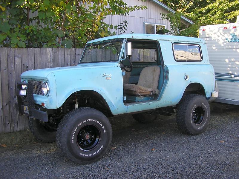

My opinion regarding the parts choices you have now...go with the set of 3.54 axles, that ratio is just fine for your use! And then set aside the budget to either refresh or exchange the calipers and have the rotors turned...hopefully they will turn and not end up being scrap, but dealing with boneyard brake stuff is always dicey. Toss the oem proportioning valve as it will most likely be crap also if it's set around open to the atmosphere, budget another $75 for an adjustable proportioning valve installed in the rear circuit only, with the front circuit plumbed straight thru. Since the axles came from the same donor, then the rear drum brakes already have the proper diameter wheel cylinders to match the front disc setup when used with the oem proportioning valve. Budget for new flex hoses also.
If you keep it spring under for now, and want a bit of a lift for appearance...use the 5" (or 6") CPT shackle set front and rear, along with 5* spring wedges in the front only. That single set of changes will vastly improve straight ahead tracking and allow the steering to self-center. You could install the same wedges in the rear if ya think ya need to help the pinion angle a tad. The 5" shackle combo will provide about 1.5" of "effective" ride height increase on the stock springs.
It looks the same as my '64 color wise, but we cannot find the actual IH color (name) in any of the paint charts out there. Vegas blue and turquise from that year don't match at all, we mixed up a small bit from the paint charts. We ended up going with a color out of a spectra chart??? Its a dupont color but doesn't have a (name) it is very close to the original color, but would be nice to have a name for it. We came to the conclusion that since it was a canadian truck there might be differences in paint colors, but this picture you posted looks almost identical to mine colorwise. If anyone has a name for the color I would be happy to hear it... Thanks
