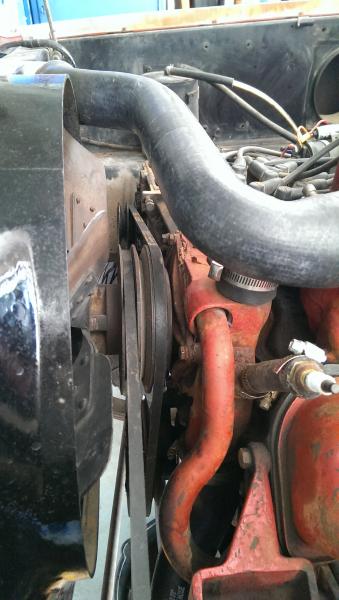

new to the forums and to Scout ownership....loving and hating my rig at the same time.
Quick question I have a 1972 Scout 2 304 and my water pump is leaking and I was going to replace it but they asked me if I needed the magnetic one. I didnt understand him so I wanted to see if you guys could help with this picture. Also, is there anything else I should replace while im in there? Thanx in advance!

If it was me, id double belt the water pump/alternator.
What is that spark plug and house clamping off?
Maybe the part guy met what kind of fan do you have ??? Is the “big” nut water pump a magnetic clutch ? From the looks of the picture, you have the "normal" water pump not the "big" nut style
im sure if you call the store they will get you’re the correct water pump.
Welcome to the forum. There's nothing really magnetic about the big nut style water pump and clutch fan combo. I'm not sure why it is referenced that way, but in some parts literature it still is. It is easily identifiable by the very large, solitary nut that retains the thermal clutch to the pump body. Like the previous member said, you don't have that design. You have the 4 bolt hub style with a direct/non-clutch fan blade. Very interesting, "agricultural" usage of a spark plug to block off one of the heater hoses. If you're wondering why your heater doesn't work, that's the main reason. You've got the fan shroud in place which is one of the most important components of the cooling system. You've got the necessary pulleys to run dual alternator belts, so that suggestion is a good one.
Thank you guys, and I'm not sure why the original owner blocked them off but I have plenty of other things to fix before that :) (summer is coming soon and I live in cali, whats a heater ?? Lol)
