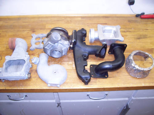

Heres the question: I am rebuilding and turbo charging my 304 and I was told that I need to buy forged pistons instead of having cast or hypereutectic. Is this true or is my machinest pulling my leg?

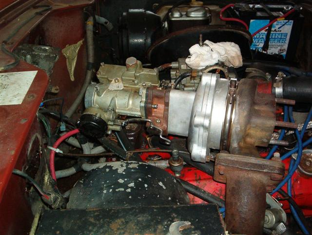

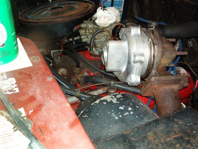

for a draw through system like I think you are building you can get away with not cooling the air charge up to 8-10# boost but it can be touchy because of high air charge temps.
Blow through systems will need air charge cooling above 6# boost to be safe and reliable. Heat is your enemy.
