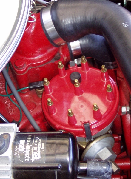

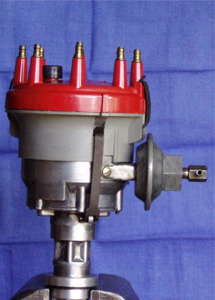

The Ford duraspark II conversion on the Holley distributor is relatively easy on the 304 engine but I understand some 345 and 392 engines with the different size (larger) intake manifold might not have enough metal thickness that can be removed without damaging the manifold. Check with others that have done the conversion on the 345 or 392 engines. These images are for a 304 engine.
