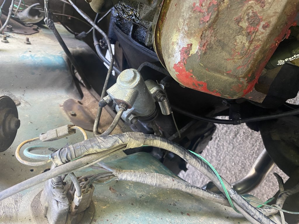

Thanks, I’ll check there first! I did replace the slave cylinder so I wouldn’t be surprised if it’s leaking now haha
sorry I didn’t include a photo, it’s intermittent so there’s nothing really to show now.
Slave looks bone dry! Maybe it will start to leak after driving around, but I’m not sure that’s the problem. I tightened the fitting a bit but it’s already really tight.
