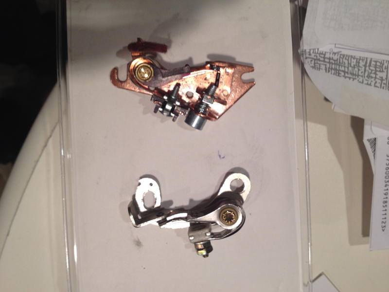

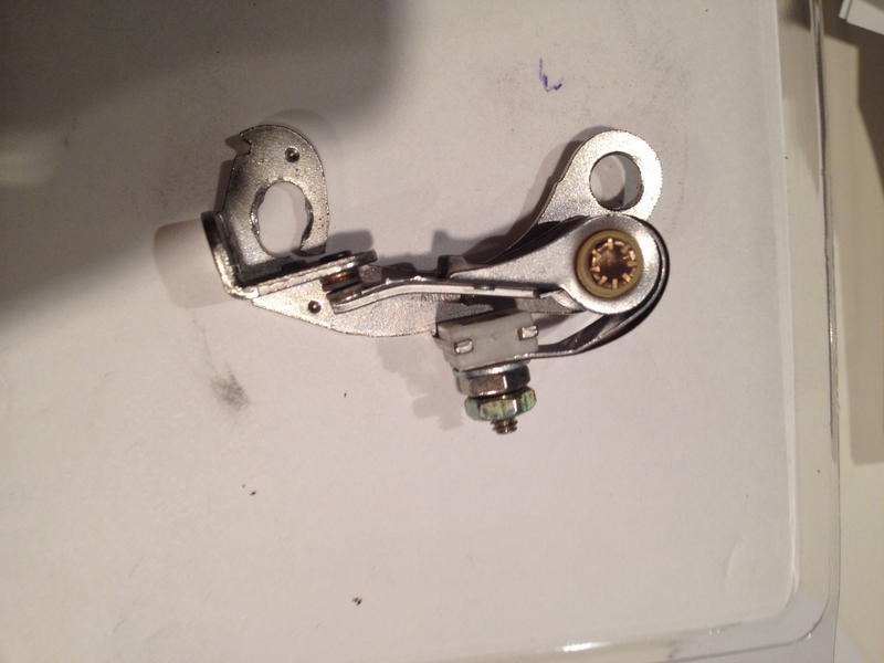

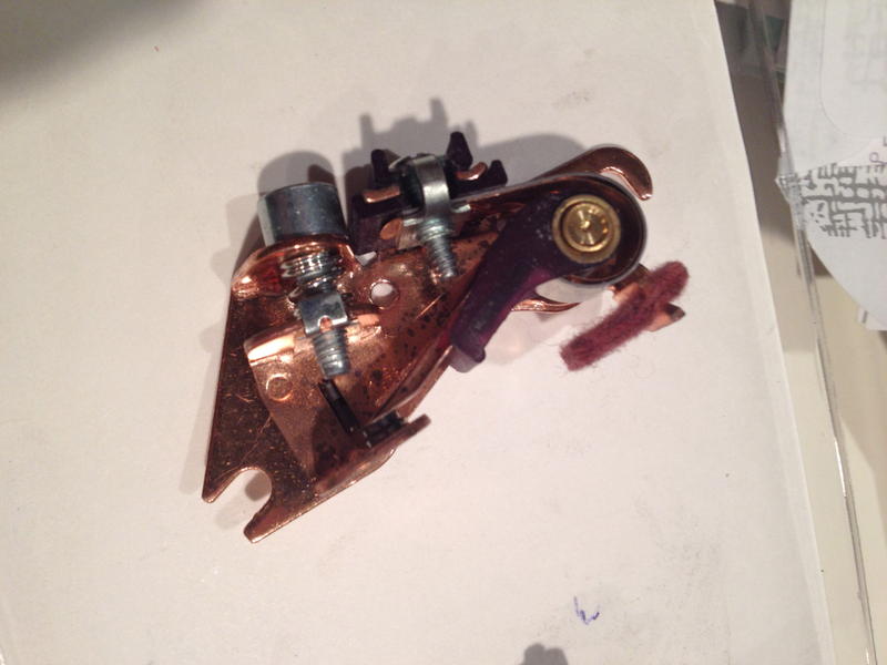

the brand new points that I picked up last weekend were not the right part, will post pics. There was only once store in town that had them in stock and they swear it is the only option for my year (standard dr2270p). Now I need to track down the right replacements, hopefully today.
I was using part # echlin cs757p, is there a better number or different number? Pic # 1 both points, old on bottom, pic # 2 old points (right), pic # 3 new points (wrong).

Your old points are shot, the contact don't mate squarely even. Been a long time since I've done points as all my rigs use pertronics ignitors, but it looks like you've got a curved point dizzy.
