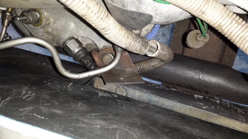

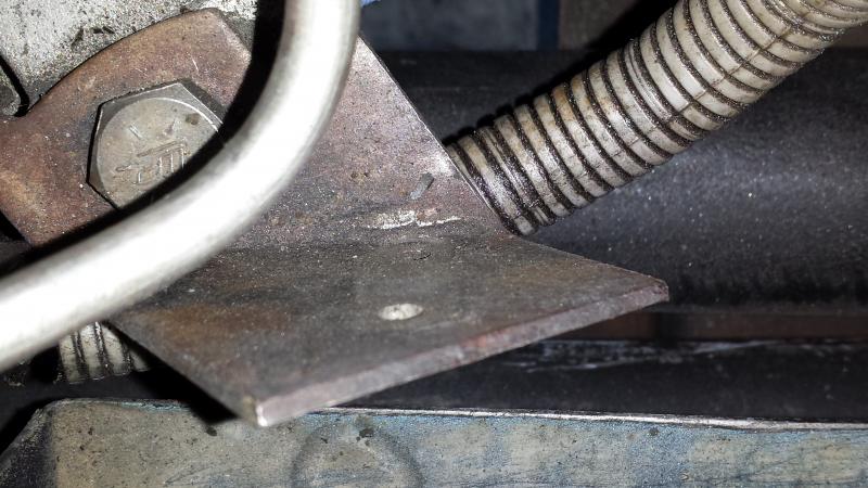

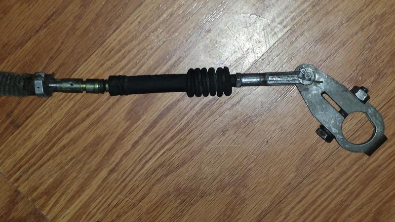

1979 Scout 2, 345, 727. I rebuilt the trans put everything back in including shifter and shifter cable but I am missing the part that holds the bottom end of the cable onto the transmission to hold the entire cable in place and stop the whole cable from moving. I remember it is a phillips head screw that holds the piece to the metal tab bolted to transmission but I forgot what the actual part looks like, can somebody send me a picture if the have a similar setup. I attached some pics to give a better idea of what I'm talking about.

Its a two-piece brass finish clamp consisting of a flat bar with two holes drilled through it and at u-shaped top piece with wings. The wings have matching holes drilled in them and the bottom surface of the u-piece has a tab that rides inside the notch of the shift cable. There is a similar, if not identical setup found on the rear of the gear selector to clamp the cable down on that end also.
Thanks for the reply scoutboy, I can always count on you for information.
Jeff - yes,that is the part.
I'll give a look around my parts and if I can't find it I will definitely get the part. So awesome to be able to get the exact part, you guys provide an awesome service.
