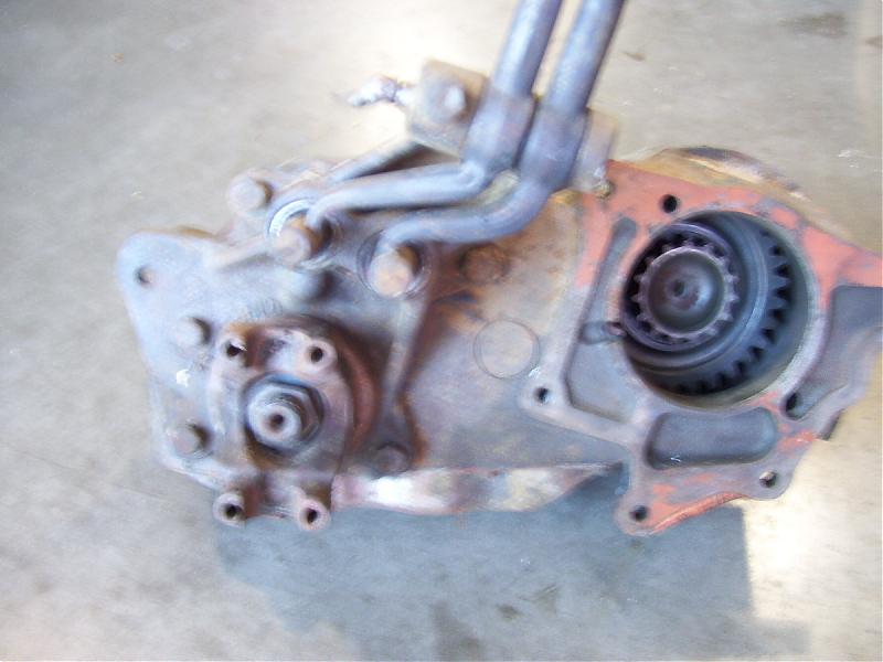

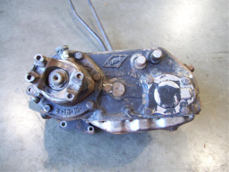

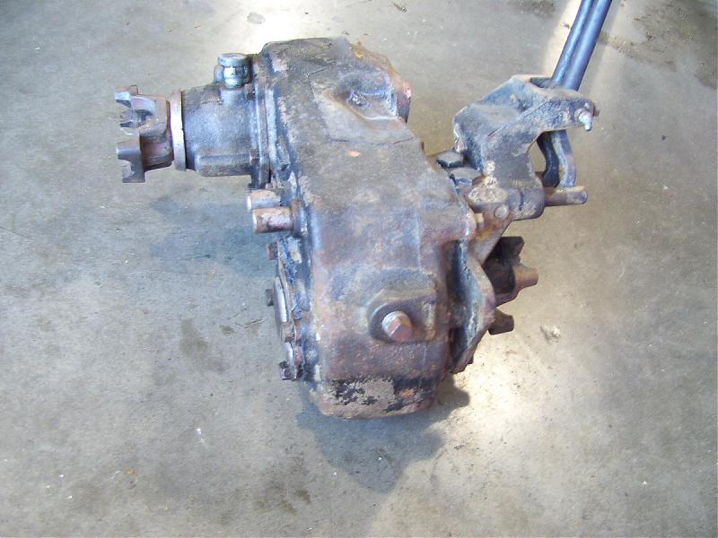

Does anyone know what kind of transfer case this is?

Thanks, I would like to get the correct shifter knods and boot. Do you carry them? Is this good case or is there a better option without spending a lot of money.
Yes we carry both the correct knobs and boot.
This is a good case especially since it has the factory twinstick. Just be sure to use the correct bullgear(input gear) that came with it as later Dana 20's had a slightly different pitch to the gear set.
This case was in my project "hemi Scout" on your forum. How do I know if it has the correct gear or if it needs to be rebuilt?
Wreck, Jeff should be in the air right now on the way to loweryankeeland.
There is a Dana/spicer part number on the input (bull) gear you have. Can you post that number and we can determine which one you have?
The pitch of the input gear, and the pitch of the main drive gear in the tc must match. The "early" gear has a pitch angle of a nominal 17*, the later gear set has a pitch of a nominal 22*.

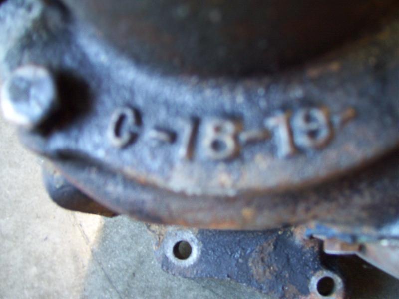

One more thing...in your jpeg #1018 above, that part number cast into the case is the part number for that part, not the transfer case assembly itself. Each d/s part normally has a part number on it somewhere, in the case of the gears, the number is sometimes vague but can be raised through the use of heat and dykem blue.
The actual bom number for the case is onna stamped sheetmetal tag under a retaining bolt for one of the retainers. That is the "critical" number. And a d18 and d20 share many parts also.

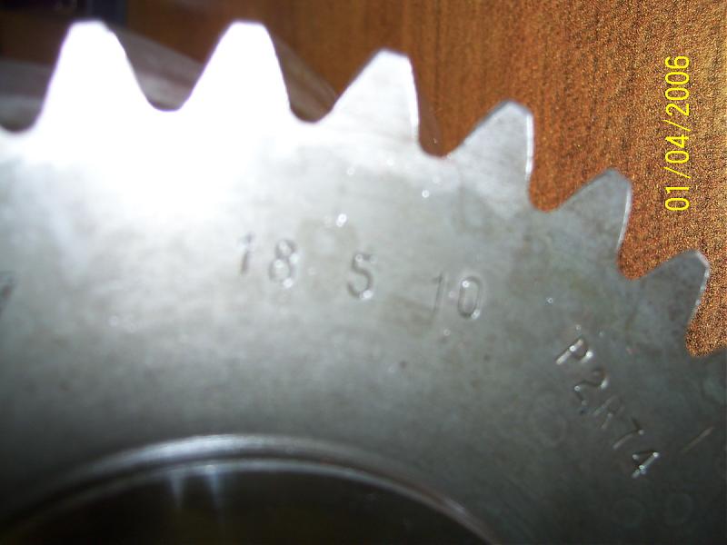

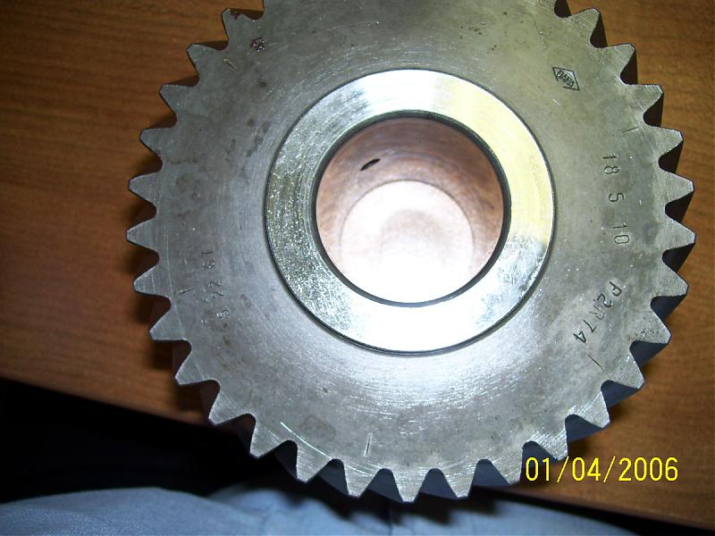

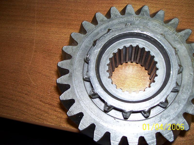

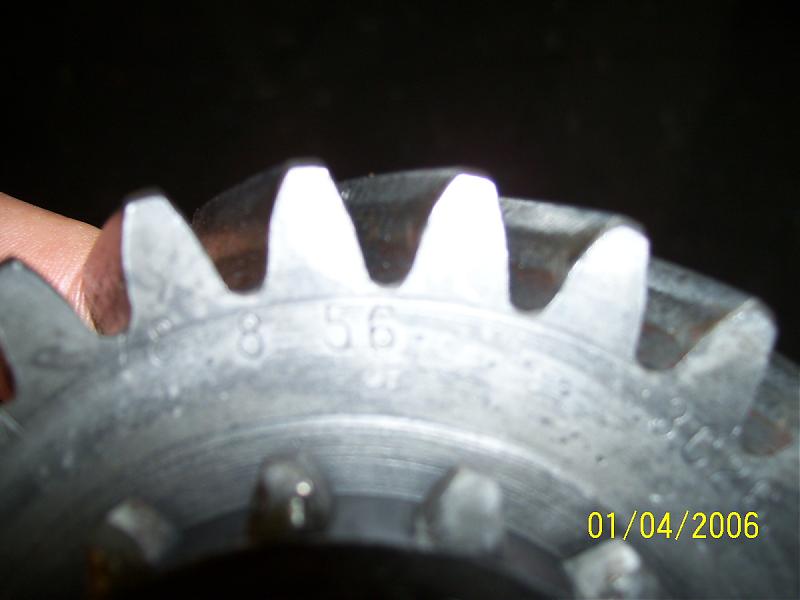

I have removed the gears in question. The gear from the transfer case has the numbers 18 5 10 and the gear transmission has the numbers 18 8 56. Are these a match? I also need a service manual for a Dana 20, a rebuild kit and the two tail shaft seals for the 727. I hope you can help.
Ps. Will this transfer case handle 360 horse power at the flywheel or should look for something else?

I'll try a stab at your gear numbers.
I'm using novak adaptors' chart and interchange guide:
the novak guide to Dana 18 & 20 gears interchange
I've found this to be trusted information for all the work that I have done on d18's & d20's, it's authors are sources of work and information for the 4x4 gear biz. It does show the 18-8-56 gear to be IH specific for the tf727, and has a 17.5 degree tooth angle. The 18-5-10 intermediate gear has the 20 degree tooth angle; it is not compatible with your present input gear. You would need the intermediate gear 18-5-16 to mate with your autotransmission's gear 18-8-56. As Mike has mentioned, they will "mesh"; but not correctly and are short lived with noise and heat. Here's a rebuild guide from the same outfit, and I have found it very helpful in addition to the service guide cts 2450, :rebuilding the Jeep / IH Dana spicer 20 transfer case.
The tooth angle is the helix angle with respect to the gear's axis. Getting 2 gears with different angles to mate or mesh is like getting a 4x4 rig up a trail with 2 different but close axle ratios, it'll go some distance but close is not good enough.
I have no info on the hp question.
