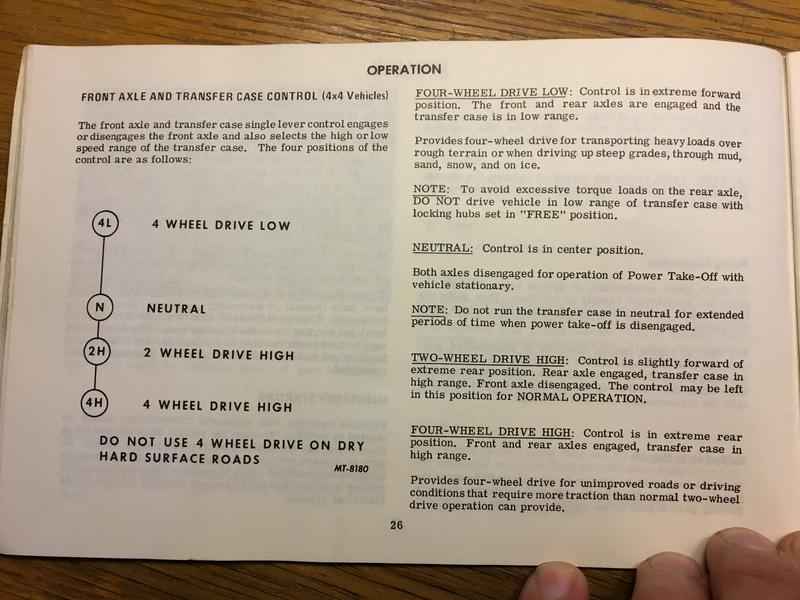

When engaging 4 wheel drive on my 1967 1100b 304
The level feels as if I’m engaged in 4 wheel high but when I release the clutch in second gear no movement
Pull the level back further and low 4 wheel drive is engage
Release the clutch and the truck moves smooth thru all gears with a top speed around 20-30 mph
Linkages on the transfer case appears normal and functioning as it should.
Thoughts on why i can’t engage the 4 wheel high?
releasing the clutch and no movement --something must be in natural either transmission or transfer case probably transfer case
a top speed of 30MPH--- is your shift knob or shift pattern miss labeled ? sounds like you are in low range and not high range
Oops, never mind, this diagram is for a D20
Referencing the 1967 Model 1100 4x4 in your post: you should have a NP-202 transfer case.
Shift pattern is attached........
Correct with the 4 x4 lever pulled fully back towards the bench seat I’m in 4wheel low
The lever pattern is a you’ve posted in the second photo, full forward towards the engine 2 w high , then 4wheel high and 4wheel low.
I’ve seen how the transfer case engages through all the options
Can’t understand why it skips the middle option but is fine in the final option...makes no sense cause it’s good in 4wheel low
