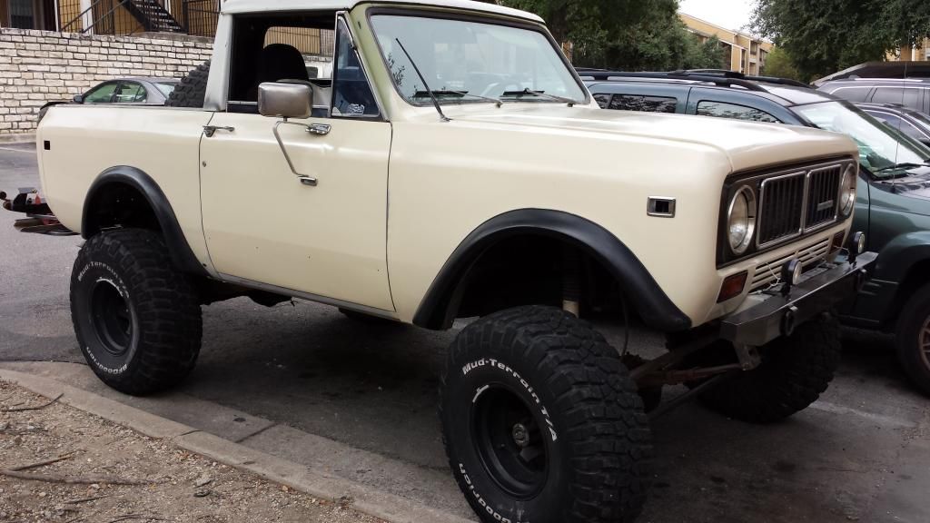

So I recently acquired a bad *** half cab '71 sii 4x4 with a 345, 4spd manual (bw t-19 I believe) and d20 tcase. The rig has front/rear d44s with cv shafts and runs 35" bfgs. I also have a TBI conversion on the 345...I'm by no means a master mechanic and will most likely have this all done by a shop here in san antonio. I'm just trying to prep and find needed parts.
