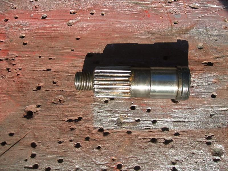

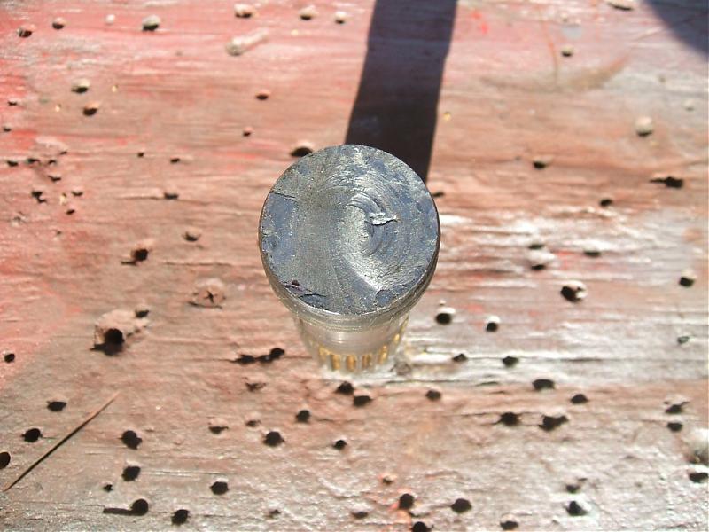

The verdict is in. The output shaft was broken aft of the speedo drive gear. From the way it looks the shaft was definitely fractured for quite some time and all the 392 did was finish it off. Will post pictures next time I'm doing downloads.

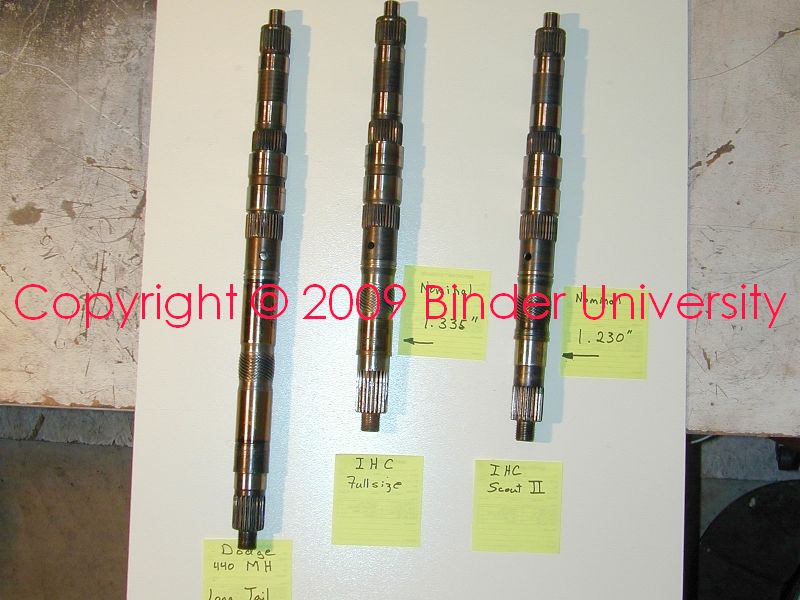

All tf 727 units have a helix cut into the output shaft to drive a speedo pinion of some sort.
But there were many different tailshaft lengths and configurations used depending upon oem application. Some tailhousings had a speedo drive pinion system installed that mate with the helix on the output shaft. Some had the speedo pinion drive in the transfer case so that the speedo reading would be correct depending upon which "range" was selected.
In the case of a 727 with d20 married inna Scout II, the speedo drive pinion hole in the tailshaft housing/transfer case adapter is "blanked" with a dummy speedo pinion with no pinion gear installed and cap installed.
Here's a pic I've posted in another thread of three different types of 727 output shafts, ya can see the speedo helix is present on all three.

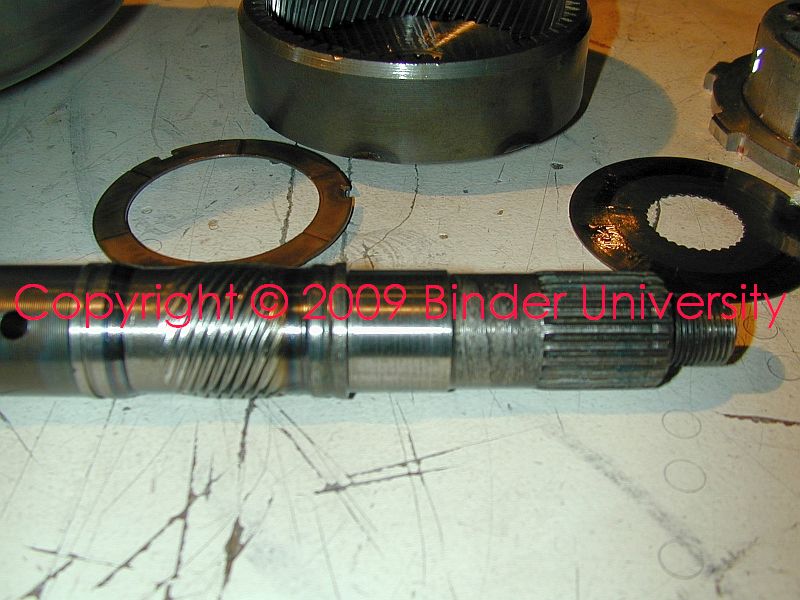

This pic shows the area of the output shaft under discussion, this one is not damaged and is still in operation three+ years after I built the trans, it's a very early chrysler 383 tranny being pushed by a warmed over 383, and has a Scout II output shaft and tailhousing grafted on.
Rig belongs to our supplier of the "special" output shaft bearing used only on a dam Scout II tailhousing, terry davidson of precision bearing fame. He custom builds those bearings only for ihon.

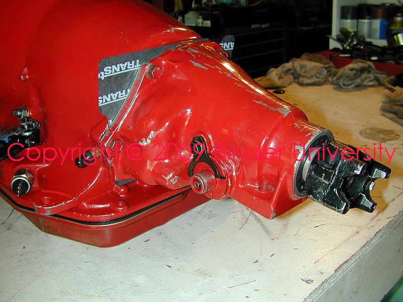

This is a shot of the tailhousing used in ihc pickalls, either 2x4 or 4x4. Also used in 2x4 Scout II.
The pickalls use a divorced np 205 transfer case if a 4x4 app. This is what we refer to as the "short" tailhousing with the bolt-on yoke (not a slip yoke as used in many 727 apps).
Note the speedo drive,...if the tranny is a 2x4 version, there is a pinion installed in the adapter like this one. If it's a 4x4 app, then there is no pinion installed, a cap is placed on the adapter, and the speedo drive is out of the transfer case.
A different version of this tranny was used in ihc-produced motorhomes/chassis, that one was a long tailhousing with an extra mount added, same as the app for a dodge motorhome app. Still used a bolt-on yoke though, a slip yoke system was not strong enough.

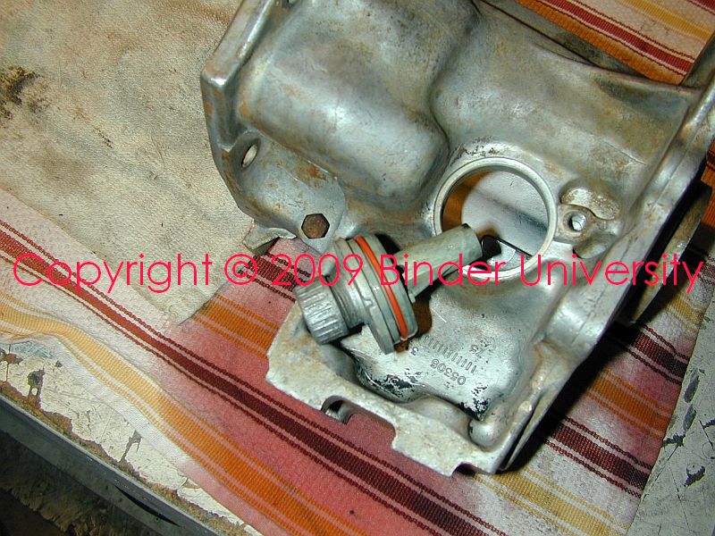

This pic shows a speedometer drive port in the Scout II transfer case adapter/tailhousing along with the blockoff used for the speedo drive area. This is all oem stuff.

Drum roll please:
although the other half of the shaft is still in the tranny, it sure looks like this shaft has been busted for some time. It appears about 2/3 of it has kind of a polished buffed look to it, like it had been cracked but just barely being held together. The last third is freshly broke.

Thanks for finishing out this thread Jesse, that's the only way we can learn what works and what don't! And what's strange.
Robert is much more into damage analysis/metal fatigue due to his training and background...but I'd have to say from what I can see in the pic, that no doubt some existing damage would have been revealed inna magnaflux process on that shaft. But nobody would ever do that unless building a super-high end race box.
