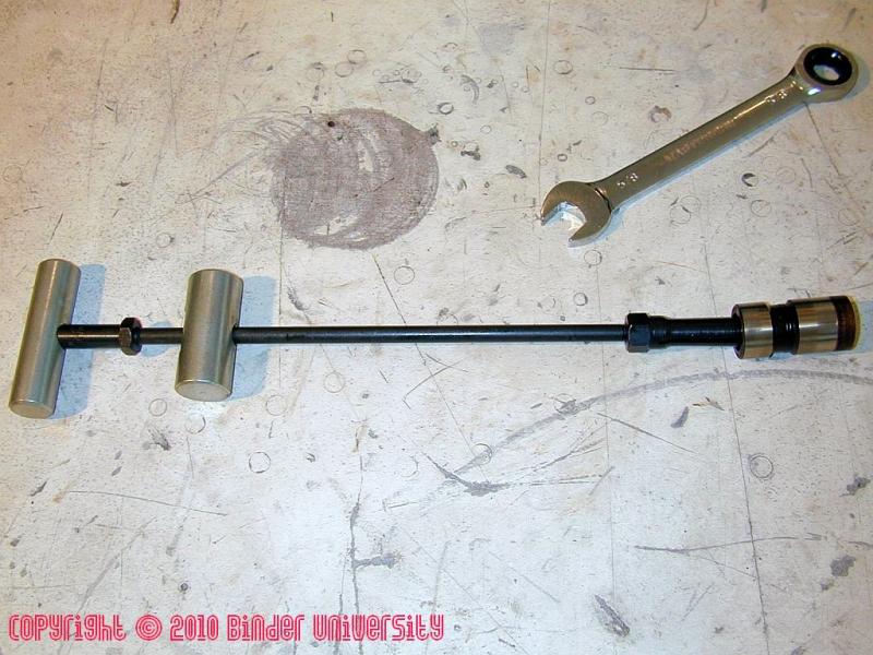

If the lifters won't pull straight up using a strong magnet, then slather 'em with berryman's chemtool or walmart house brand carb cleaner. That will help break down the varnish, it takes much patience and working with 'em continuously to get 'em free. That motor is a worst case situation for varnish!
Even with continuous soaking in solvent, I bet you will end up having to use a "lifter popper" tool to extract more than one! I don't waste time trying to do the solvent extraction multiple times, I do it once and then go for the tool!
