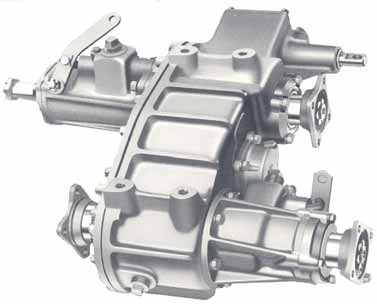

I've got a rare (1 of 932) 1954 R-160 4X4. These trucks had a massive Timken T 32 transfer case. The only PTO option is a full engine torque rear-facing unit that I'd love to get my hands on. Not to mention a basic rebuild kit for the T-case. Any information on these transfer cases and on the PTO unit would be greatly appreciated.
On these trucks, the diffys are both offset to the passenger side, so the transfer case PTO splines directly onto the back end of the input shaft. Great for the Bell Telephone trucks that drilled the holes for installing new telephone poles, for example.
In the attached drawing of this unit, the input shaft is top right (well, one of the two t-case shifters is at the very top right), the PTO mechanism is top left, and the front and rear output shafts are at the bottom.

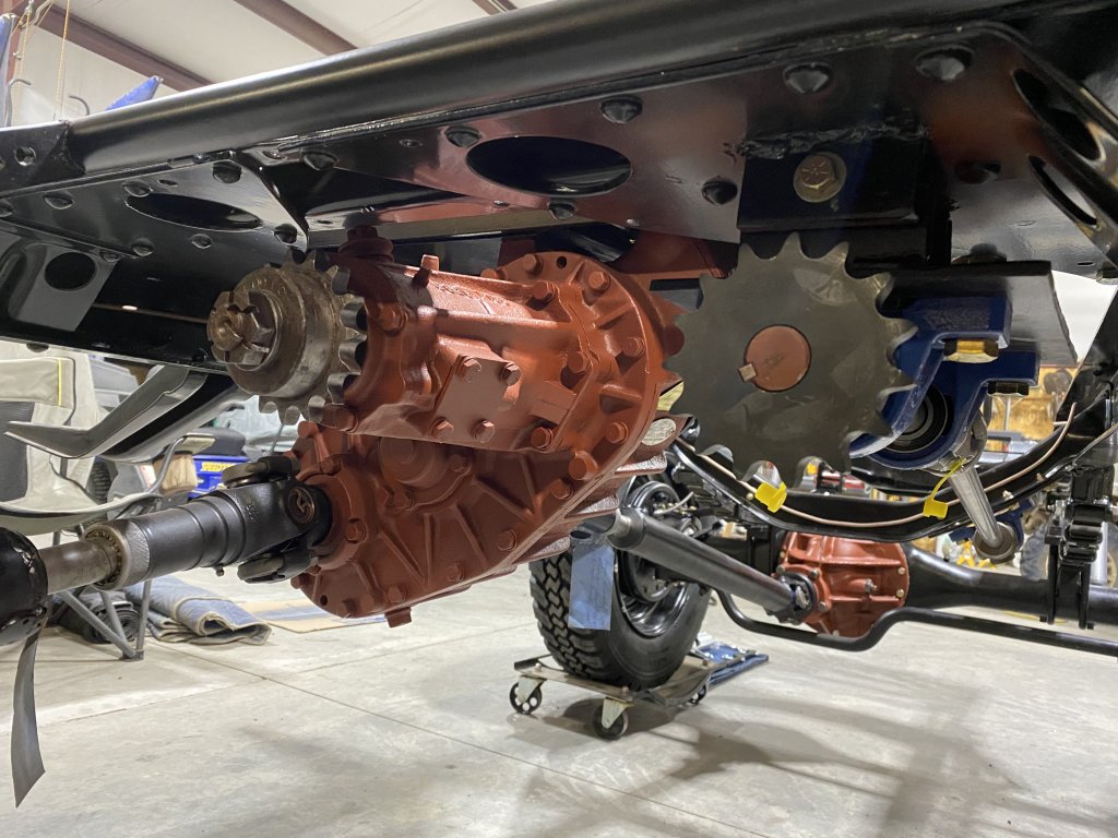

Came across this today. Not sure if the original poster is still following. I have a 1955 First Series GMC NAPCO with the T32 and the PTO referenced in this manual. Happy to answer any questions you may have.
Thanks for noticing my old post. While the IH T-32 transfer cases are passenger side drop, they are apparently otherwise identical to the NAPCO versions. Where did you get you rebuild kit? And if you have a source for another PTO, I'm very interested.
Yep, the driver/passenger drop is the only difference I know of. Fortunately, I didn’t have to rebuild mine...the original owner had it rebuilt years ago and never reinstalled it...it just sat on the shelf until I ended up with it. I think DT Components makes rebuilt kits, but I haven’t had much luck communicating with them...you might give em a call though. I don’t know of any other PTOs like the one in question, there is a NAPCO Chevy for sale on Craigslist (Seattle) right now that likely has the same PTO, but I’ve been told, and found them to be quite scarce.
