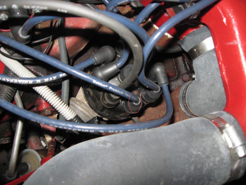

Here is a photo of the #8 position that IH utilizes.
#8 has a red circle around it.
