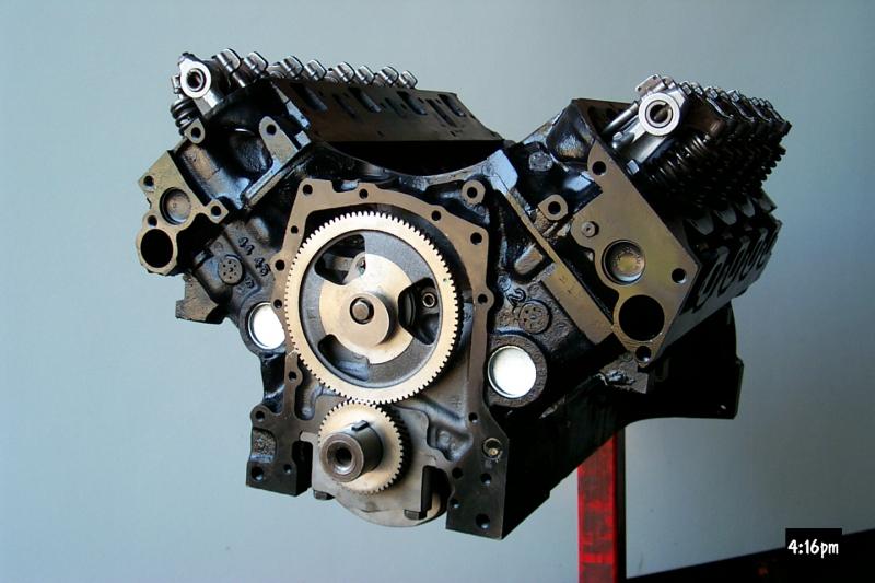

With the timing cover off, it will look almost like this, only without the left bank of cylinders & left cylinder head.
