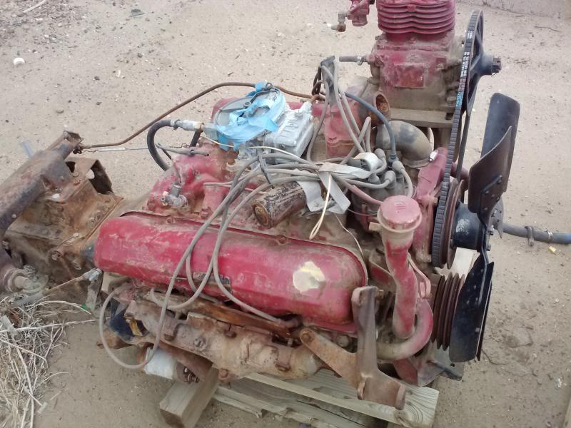

The loadstar moves foward. I have a line on a 304 from a co loadstar still attached to its wee transmission.
Even better I get a nice air compressor out of it.

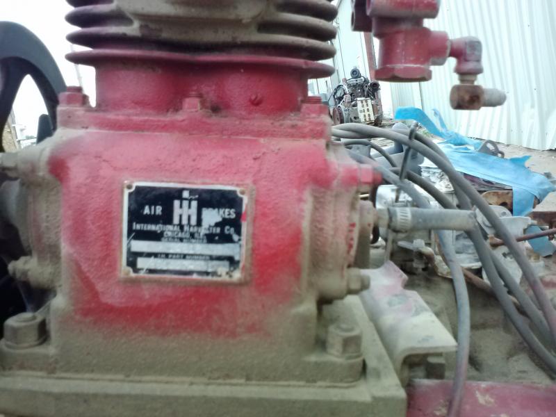

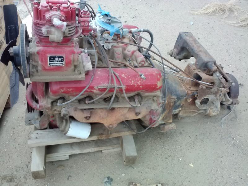

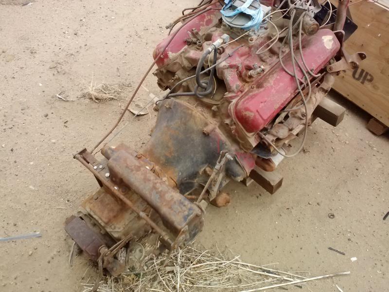

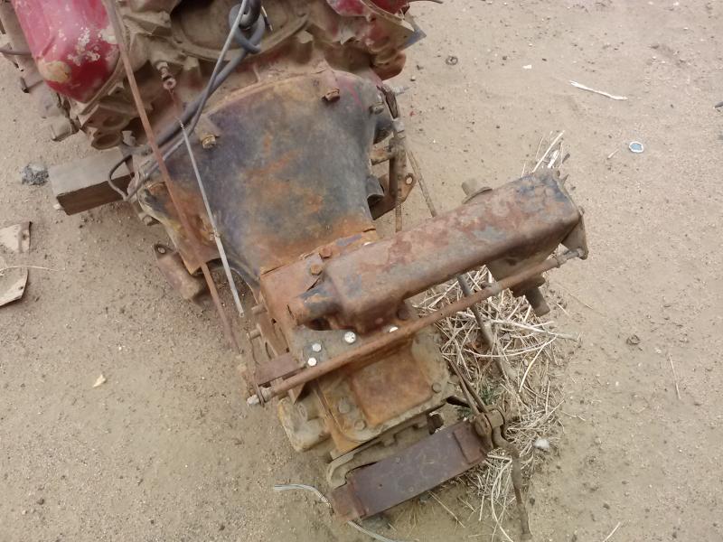

Man I am drooling over your air compressor!!!!!! Thats what I need for my rig so when I drive my Jeep on the bed I can air down the tires and I can also adjust them for different trails once unloaded! Sooo sooo lucky:) really cool to see to man. The new names fits and good luck on the parts coming your way good deal:icon_lol: whats the thing taking place off the trans shifter stick?? Looks like a chunk off how does that work to shift?? T98 tranny? The engine looks fairly clean which is a nice sign lol I am at the expensive tire stage myself:icon_crying:
Its actually a borg warner t-19. Thats a remote shifter of sorts. The cab over loadstars had colum shifters. 4 on the tree. So im assuming there used to be some horrible wiring system involved.
Yeah im gonna use that compressor for three things....horns...brakes....and an air compressor...:skep:. Since its gonna haul my toys I figure like you so....only my toys have red power plants. But if im gonna turn my pumpkin into a wheeler im gonna need the air down accessibility.

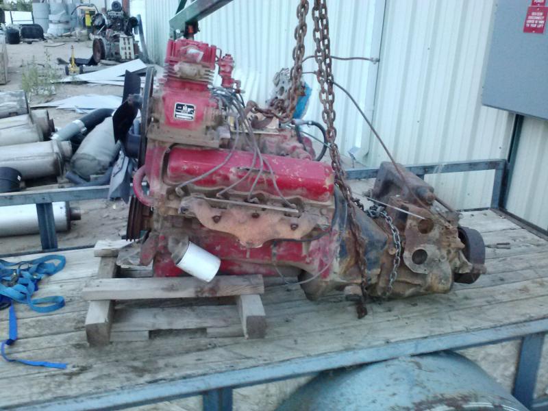

Ok come Monday I get to go pick up my engine and trans and tires.
My little 5x10 3200 gvwr trailer has to haul this crap so we'll see. 1000lbs of engine and trans
1000lbs of tires and rims.
Squatted little trailer
im trying to figger out the logistics of gettin the engine/trans up onto my trailer and about the only thing I can think of is take my 1ton engine hoist and lift the engine and back the trailer under it. Should be fun for me
next time I post on here I should be a happy wee man

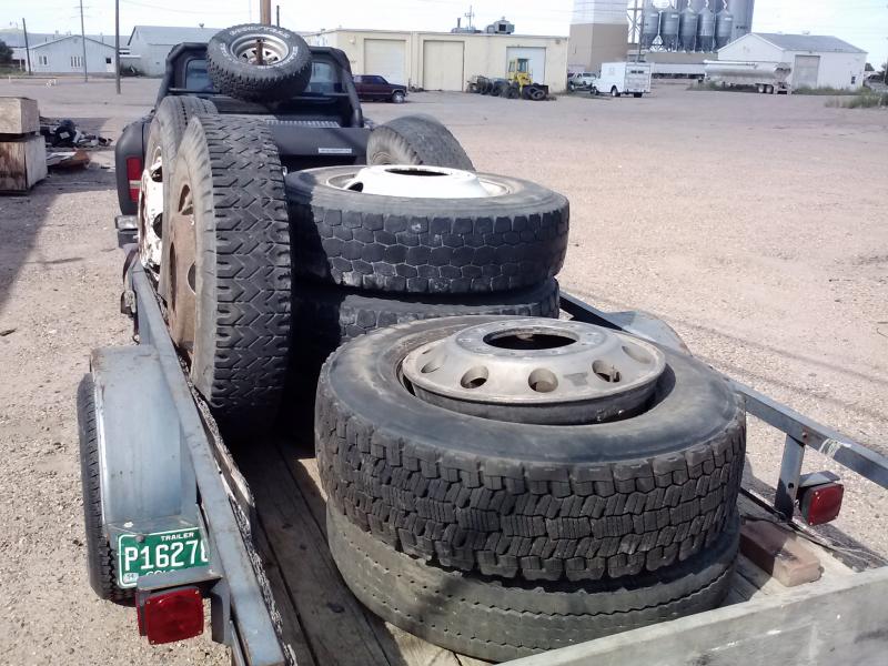

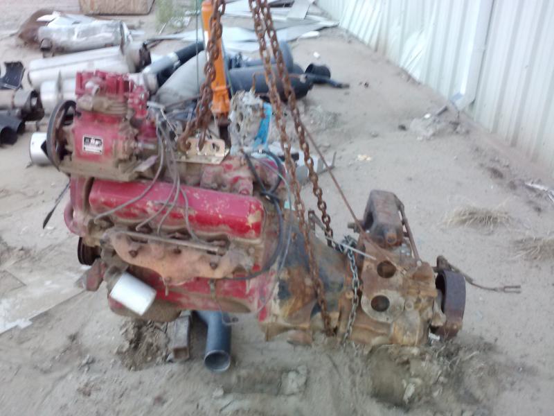

After fighting some kind of illness that is kicking the shit out of me 6 ways to Sunday I decided to suck it up and go get my tires and engine regardless of how I feel.
My 5x10 will never talk to me again. I severely underestimated the weight and size of the tires for a few reasons. One of those reasons was the 4 22.5 in rims and tires hidden on the bottom of the pile. Much heavier. The 304 and tranny I kinda expected to be heavy. And I wasnt disappointed.
Im done for the day. Totally wiped. Ended up loading everything myself.
Lets put it this way. I dont need to do my workout tonight

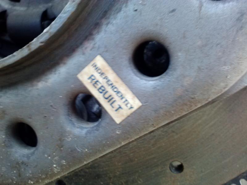

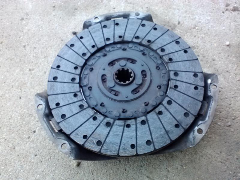

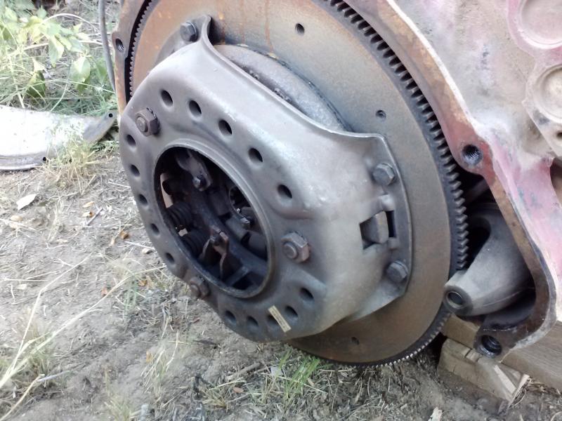

Alright, first happy update in a long time. Im very happy to report that the story of the clutch being replaced shortly before the engine and trans was pulled appears to be true.
Very little clutch material appears to be gone. Springs are new. Tob is new. Im slightly optimistic.
Regardless this is a good sign. Many usuable parts from this engine

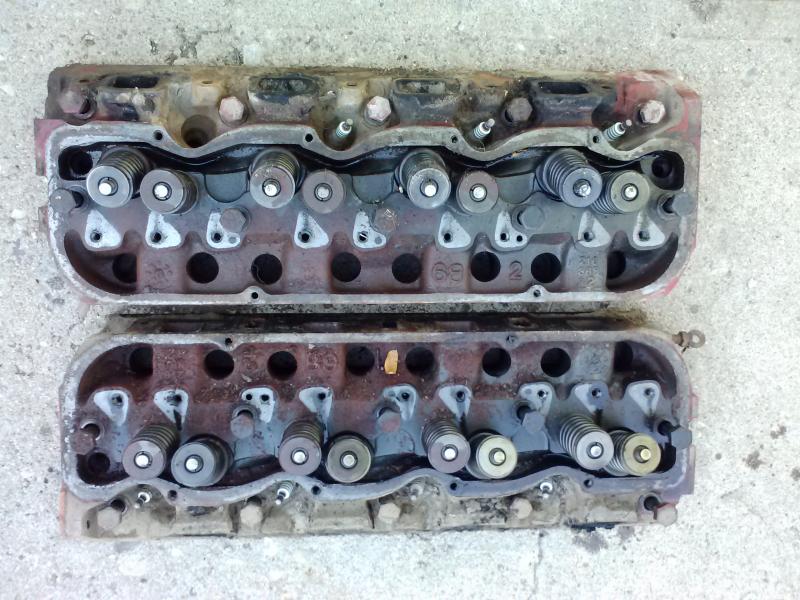

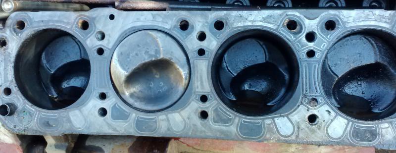

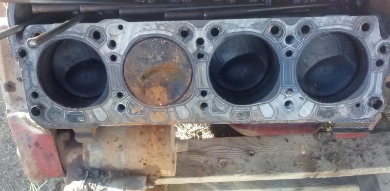

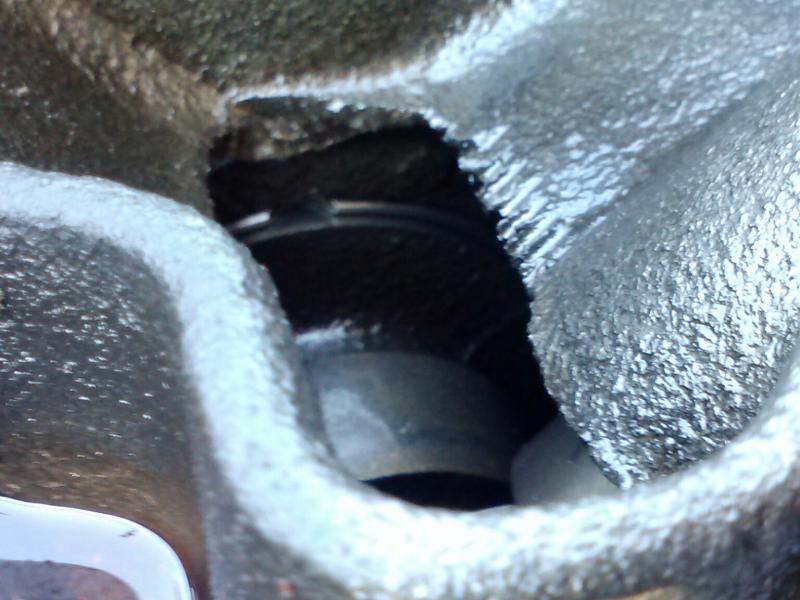

I did crack the top end buddy. Ill try and get pics up tomorrow. Someone did a poor job of covering the intake so I found my fair shars of surface rust on the rockers. And pushrods. One piston on each side both had water sitting in them (dished pistons) and from the one cam bearing I can see its missing a chunk out of it. Rearmost bearing. Again. Its what youd expect from a tired old 304 that sat through 8 seasons of rain and snow. Looks like everything is salvagable right now except maybe welded style rocker arms. Again. Not concerned. The clutch paid for itself. Ill probably rebuild this engine while im building the 392 the 304 and the 196. Might as well. Maybe IHPA will give me a discount lol. The 3 and a half engine discount.
Regardless its a good buy for me. It gives me more parts to ship to ellie. More cushion if one of my other engines fails. Im down to two 304's and a spare 196 that are ready to drop in. So a few more wouldnt hurt. When I get the toter done ill throw a Scout behind it and ill come make a trip to az and we can tear shit up! :cornut:
