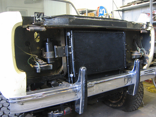

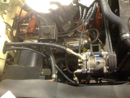

the ac unit is a stock under dash unit out of a '77. I have converted the system over to 134 with a sanden type compressor with new lines, condenser, and dryer. The system cools down to 60 degrees at idle on a 100 degree texas day. I still have to it out on the open road to see how it cools with air moving through the condenser.
