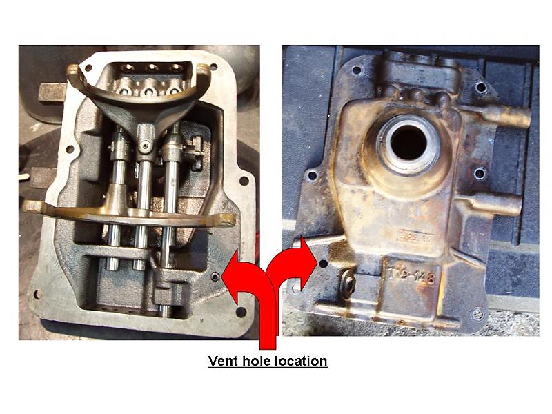

Where is the vent on a t-19?
Since I changed fluids in the trans and txr case, I've developed one heck of a leak. So, I wanted to check my vents to see if it could be something that simple.
It should be in the top cover - I wanna say driverside rear.
It is just a little vent cap unless it has been converetd to a fitting with a hose barb and hose on it.
I've never seen one that wasn't gummed up in a stock transmission.
Hi:
from my files: t-19 vent location. Its a little button affair that presses in.
Thanks for the replies and the pic's.... As always, a wealth of info here!
The odd thing is, it did not leak until I swapped fluids. I guess the new fangled stuff with the detergent packages cleaned away all the gunk that had her sealed up....
