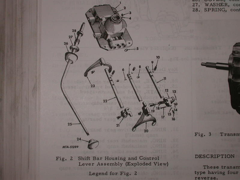

The wide T19 in my 75 Scout was getting a little difficult to get into first gear, so decided to swap the cover plate off the close T19 sitting on the garage floor - the one that was a beast to get into 3rd gear when the transmission was installed. This pretty much confirmed it is the shift linkage in the cover plate that was making it very difficult to shift into 3rd gear. With the cover plates switched,the wide T19 went right into first gear, but fought me going into 3rd. Looks like there is a problem with the "horizontal reverse speed shift lock plunger spring" the plunger (item 19) just seems to be floating with no spring pressure on it. I have a rebuild kit for the top cover, it looks like it has the springs for the shift rod ball detentes,but not the plunger spring (item 18) mentioned above. Does IHPA offer a rebuild kit for the top cover, or anyone have a source for said spring?
Thank you, thank you thank you. Just ordered a couple. The Close T19 is destined for my 72 with the no 1st gear synchro T18.
