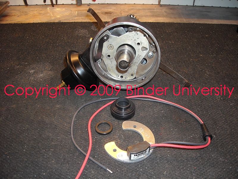

This pic is a p-tron kit ready to install in a Holley 1510 points distributor for a 196. The plastic spacer is the recently added component, this module is not manufactured with a provision for setting the air gap. The previous design units are.
