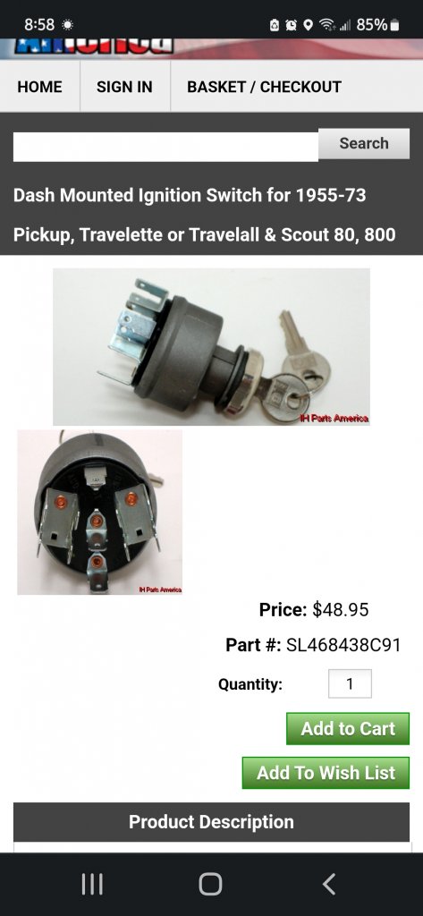

I'm thinking this is what I'll need to snag to help alleviate my problem 🙏👍
