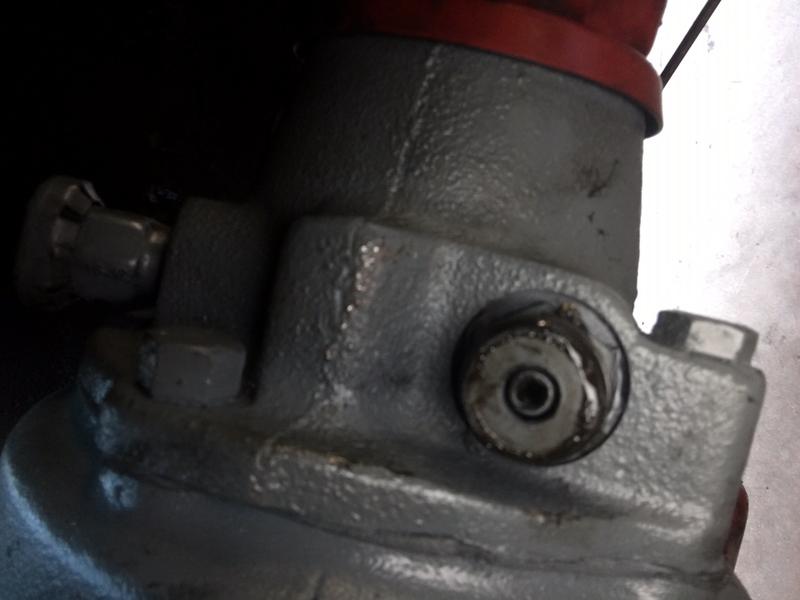

Just installed a T19 and D20 into my 1977 SII - 4cyl 1bbl. It works just fine, seems a bit better throttle response than the anemic 3 spd that was in before.
New issue: the speedometer is not working. when the speedo cable is hooked up to transfer case, no go on speedo. I tested the speedo with a drill gun - speedo works just fine. when connected to tranny,nothing. Attached picture shows the outlet at transfer case fr speedo cable. I am wondering: is it possible that the round part inside is broken? is it plastic? does this require a removal of the back end of the transfer case to remedy?
Also, the large grey object? I am guessing it is a "reducer" of some sort?
let me know and thanks?

this may be a dumb question but, I have to ask:
is it possible that the speedo cable is not turning the correct way. When i have a drill gun running the speedo cable in reverse (counter-clock wise), the speedometer shows that it's working. The speedo gear that is plugged into the D20 transfer case is turning clockwise. or am I missing something here? DAMN!
Did the 3 speed have a"reverse (CCW)" gear, and the 4 speed have a forward (CW) gear turn?
