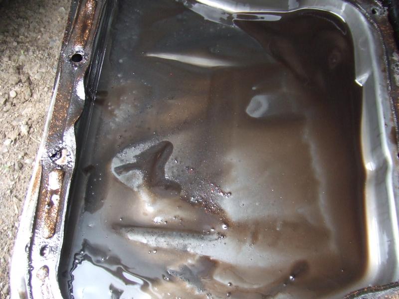

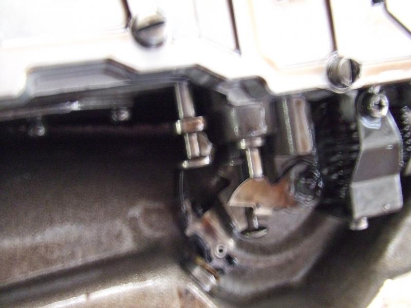

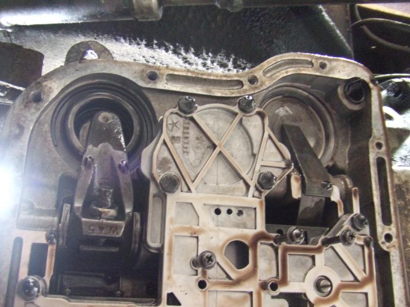

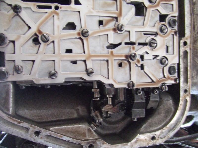

Ok I got my new tranny pan gasket and new filter. I couldn't find a inch pound torque wrench anywhere close for under $120.00 so I picked up a small ft. Lbs wrench that goes as low as 5 ft. Lbs I also picked up some 8 point sockets so I hope I have all that I need . So far I have confirmed the shifter cable is shifting I adjusted it up and down and it did nothing so I set it back to its original adjustment. I adjusted the ez band and dropped the pan and filter off the tranny I wanted to post these pics in case you see something that needs attention. The atf fluid that came out was burnt up really good but I did not see any big peices or metal shavings in the pan just very small particles that accumulated around the filter but quickly dissapated into the fluid left in the bottom of the pan.

Your pics don't show anything obvious other than a transmission that May have never been serviced in this lifetime! Typical! I can smell the dam thang from here!
The low/reverse band adjuster screw is not broken off, that is something I see fairly often now on failed units, don't know what that is!
The accumulated debris in the pan is also "normal" especially on a box that has not been serviced. I do see lottsa clutch material in that pile of sand!
If making an adjustment to each band doesn't bring it to life, then it's overhaul time!
