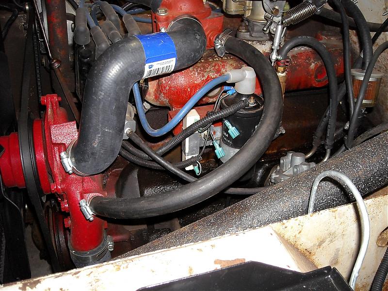

This is a long shot of a 4 banger ignition system which is my own. And it's heavily cleaned up from the oem IH crapwiring sitch!
You are looking at a delco distributor with points (perfect condition with oem advance curve), an aftermarket (this one is from msd) 0.8ohm ballast resistor, no "ballast wire" is used, the ballast resistor takes it's place, and the 3.0 ohm coil.
The jumper you see attached to the pigtail is for a ballast resistor "bypass" when using other distributors incorporating an electronic trigger (such as a pertronix 1181). Same thing is done when I install a distributor using a crane xr3000 optical trigger conversion which is a "high energy primary" inductive ignition system which eliminates the breaker points similar to a pertronix.
This 196 motor is not long for the world. It'll get yanked next month for a total buildup. Plan is to use a flying magnet crank trigger ignition system on the motor with a gutted distributor and locked out advance. Timing control will be provided by a msd 8979 ignition controller in tandem with a msd 6 box. The distributor will be gutted and only used to distribute energy to each plug in turn, no advance unit, no trigger internally. We're looking for a solid 195+ flywheel horsepower out the completed motor for street and trail use. On regular grade fuel running a carb (no efi in my world).
