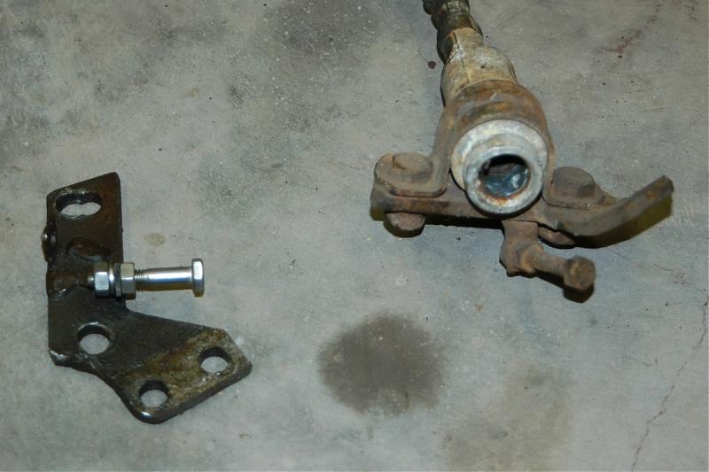

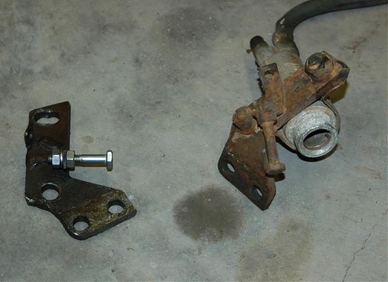

My slave cylinder mount was questionable in my mind, so I bought another one from ihon. I can't tell if it's right. The old one was flat, the new one is bent. Is it supposed to be? I was trying to line everything up (my bellhousing is out of the vehicle) and I don't see how the new one could work. Can someone say for sure?
In the pics, my old one is on the left, the one from ihon (with complementary junked slave cylinder!) is on the right.

Flat is correct and the bent one can easily be straightened. I had to tweek my slave bracket to improve alignment from the flat state. Just a little twist

I tried to flatten it out tonight. First I tried just crushing it flat in a big vice, but it was a little too tough. I next tried hammering it flat, but it ended up cracking. Maybe that's to be expected with such old metal.
I e-mailed Jeff, hopefully he can find one that is still flat.

I have n=5 of the s80 slave mounts...all are tweeked and scruud and botched to various degrees. That is exactly why I'm working up a much more robust replacement system for those that want to retain the slave in the oem position. But that is a low priority item right now.
There is no doubt that all these mounts have been tweeked in the past in an attempt to improve the geometry of the throwout system...it's pretty obvious when you see how others attempt the workround using a hammer or pipe wrench for bending into alignment, then breaking 'em off and re-welding in an even more dumazz/bizzare fashion. But by then they have already broken off the pivot inside the bellhousing casting rendering it scrap.
Only one of 'em is anywhere close to being "right" and it is my sample template (after being straightened).
