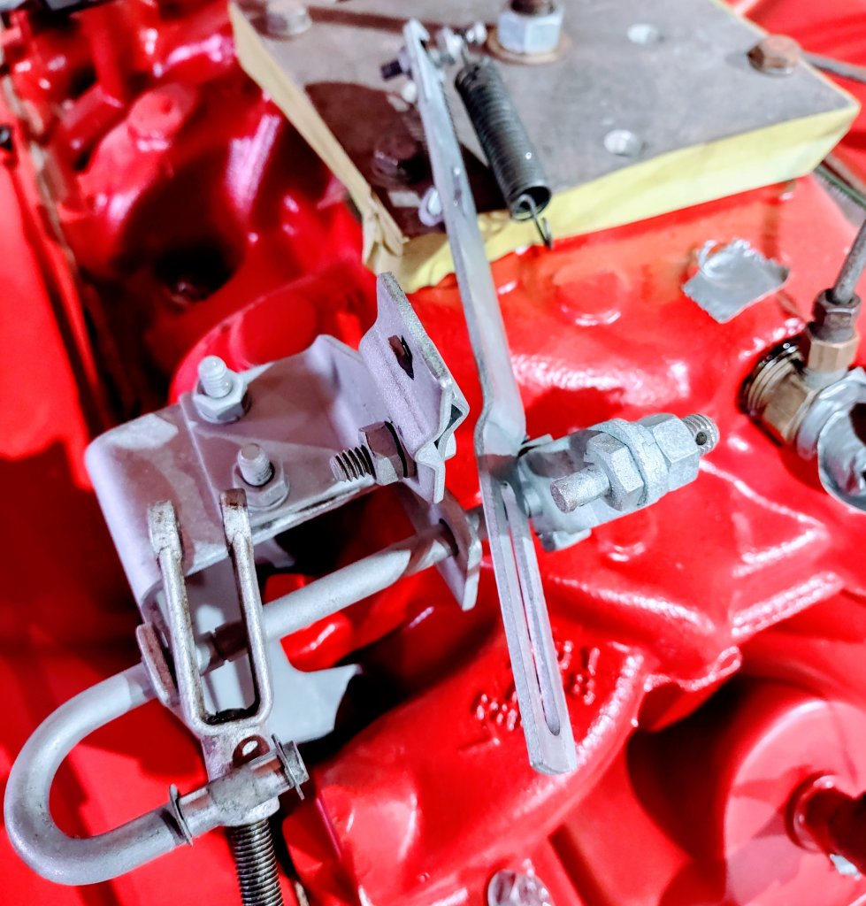

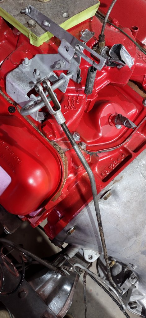

I am doing the Borg to 727 I ordered all the parts had the 727 rebuilt but do not have any photos or diagram of how to install the kick down linkage any help at all thanks
We're still working on the hookup. I'm attaching photos from a Chrysler 727 repair manual. This particular diagram is the closest one to the setup on an IH. I may have a picture or two from Mike at IH Parts America where he circles a couple of connection points for clarification.

Here are a few photos I had sent to Michael at IH Parts America. I didn't have the linkage from the trans actually attached to the kickdown assembly, but was just leaning on the connection point. Michael said this was correct.
Here's some other detail he gave me:
"Yes, it looks right. The flat arm with the ball stud gets flipped around. The spring attaches on the little hook thing in the middle of the flat arm and the hole on the end of the threaded stud that the flat strap attaches to."
Hope this helps.
