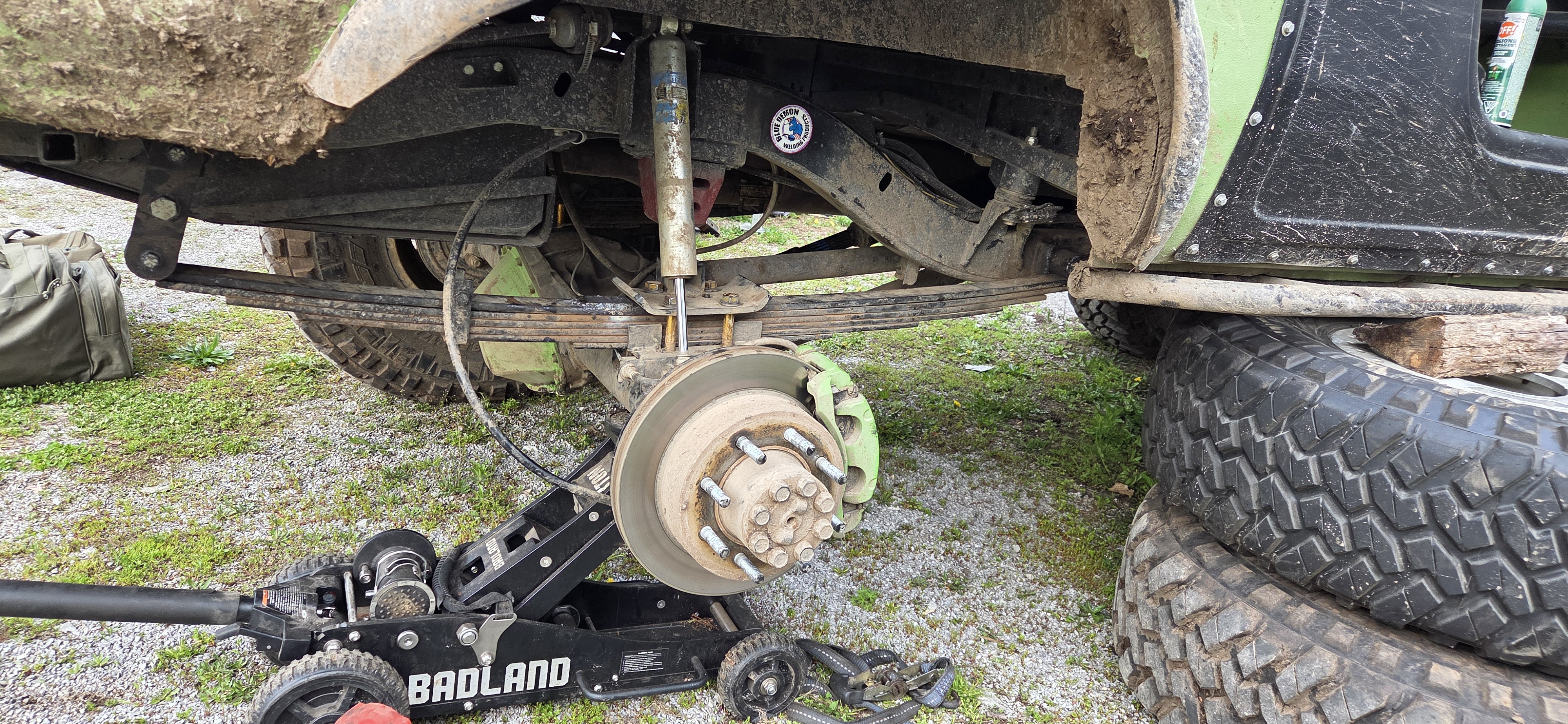

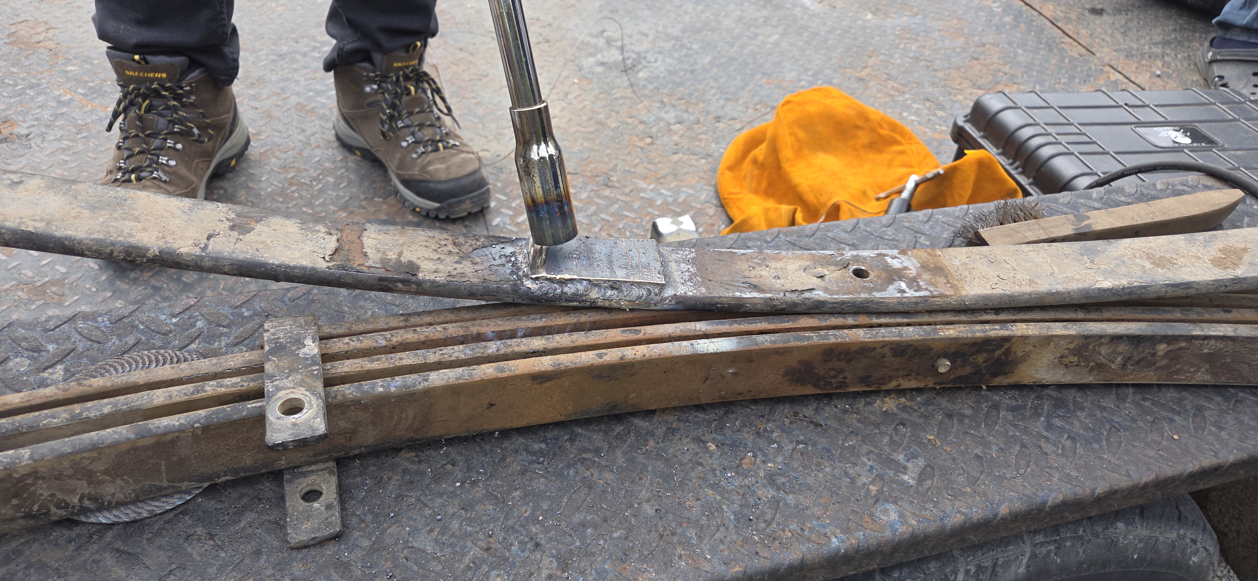

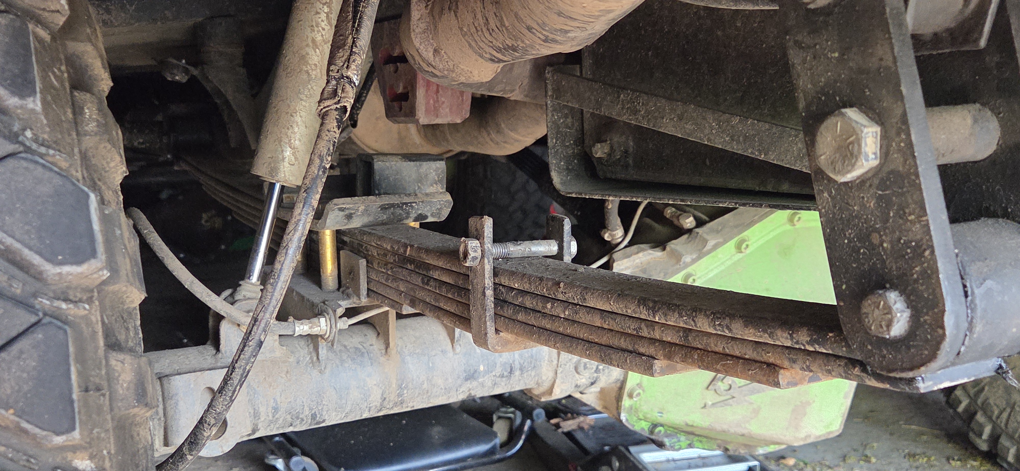

I broke a main leaf on my bastard pack XLC springs this past weekend wheeling. I run 6 leaves without the XLC overload.

I understand I may have to run a shorter shackle again if the springs lift it too much compared to how it sits. (your 5" cpt shackle on it now)

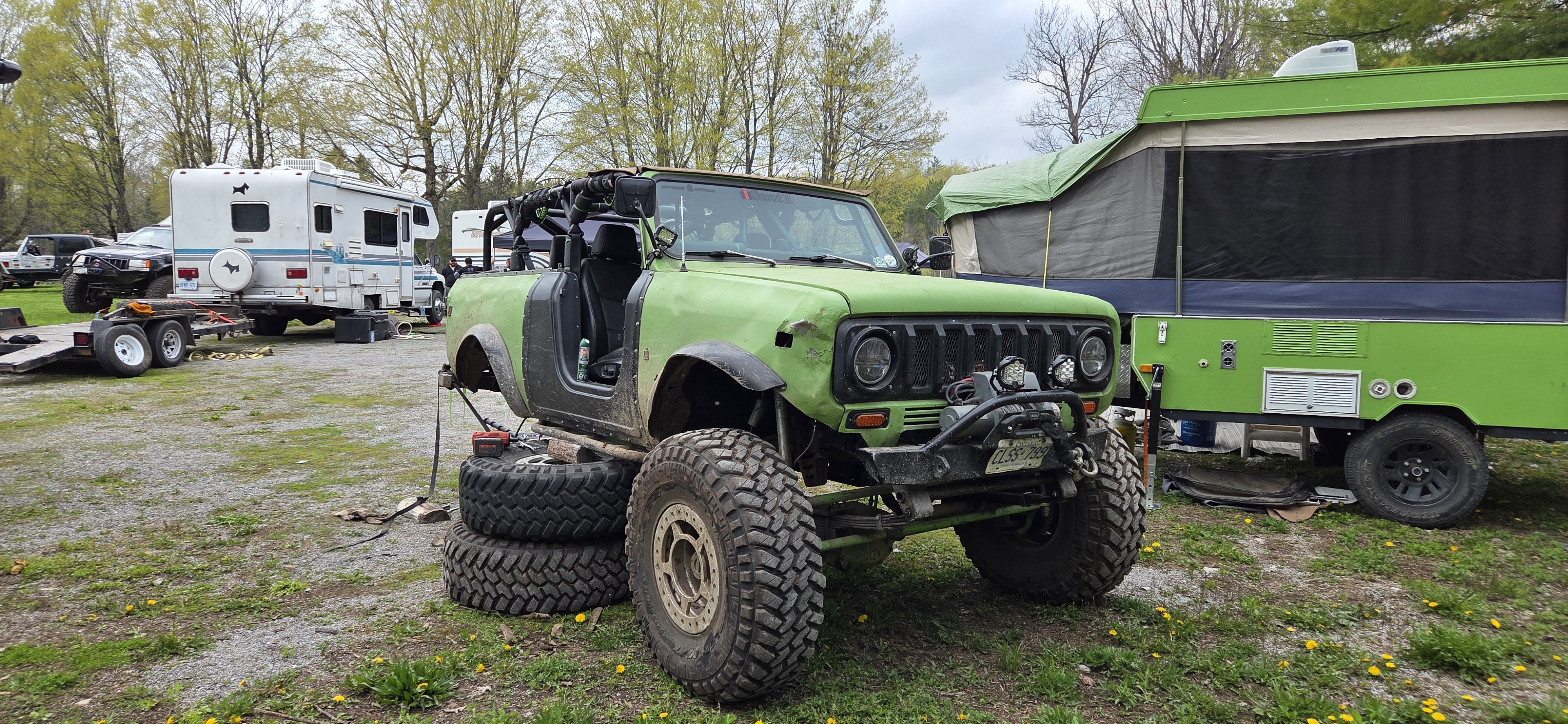

My scout weighs 6200 lbs with me in it (1 tons and 40s. And full cage)

Ps! You can weld a leaf spring and drive 400km home from the trail towing a pop up camper!
