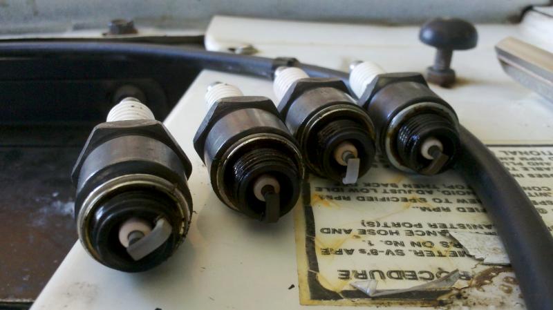

345 v8, 727 trans, new summit racing brand carb (spread to square conversion). Mostly stock. Was running beautifully. Drove about 70 miles and realized I was down a cylinder when I came to an idle at a stop light. Pulled plugs (see picture) and realized that it looks like I'm running both Rich and lean at the same time. Those plugs are sitting in order. I'm thinking maybe I have an intake leak? Any thoughts? I've never seen anything like this before.

Maybe it's the picture but they all look lean to me.

While two of the electrodes appear darker in color than the others, they don't look fuel fouled or even that sooty. From those four I'd say you're more lean than anything else.
First the clean plugs look fine especially if you were running at cruise power settings. They are usually lean of stoichiometric during cruise on emissions applications. If you don't experience any surging or running issues leave it. If you don't mind playing with your jetting fatten it up 5% in cruise and see if you pick up throttle response. Only one way to get reliable plug readings. Fly down the road at what ever range you are interested in checking for 5 + minutes and immediately kill the engine. Coast to a stop and pull the plugs. Any time idling will ruin the plug readings. 3/4- wot readings need 30+ seconds at normal operating temps to get any kind of good readings on a street engine

What really intrigues me is that every other cylinder is that ash gray on the electrodes, and the others are black.
