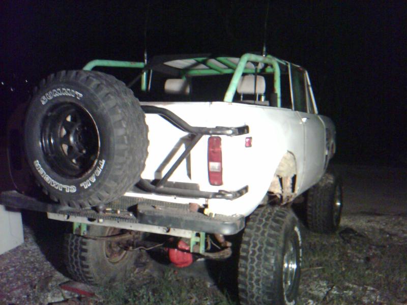

I feel like I should share this with you guys, if your wanting a nice fitting spare holder or roof rack, a 98 Chevy blazer is the way to go. I pick n pulled the stuff for super cheap and it fits like it was made for the Scout 2. Ill put up some pics of the roof rack tomorrow. But it lines up with the lines in the top like you wouldnt believe. By the way the spare holder could probably fit a 35 without modification depending on the wheel offset. Ive got a 33 on it now but ill throw a 35 on when I move up to 38x14.50s:icon_up:

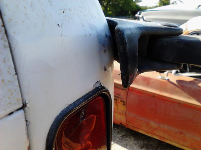

Cool! Do you think that swing-away carrier was an original option on the blazer, or is it more of an after-market item?

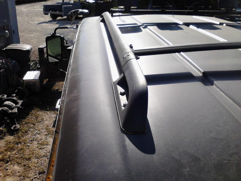

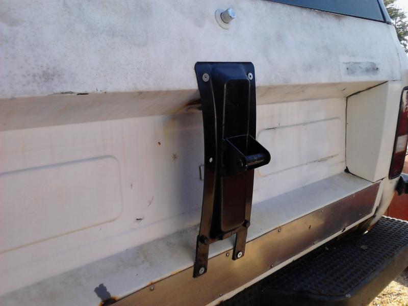

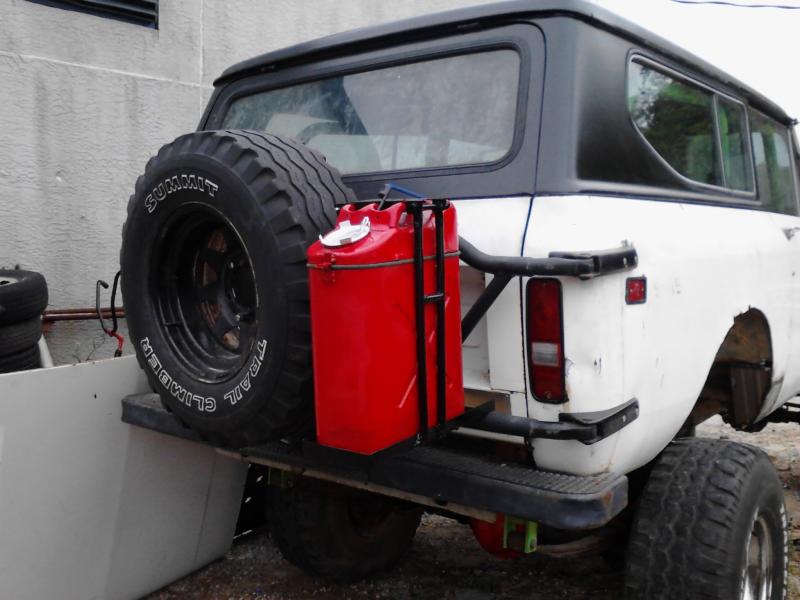

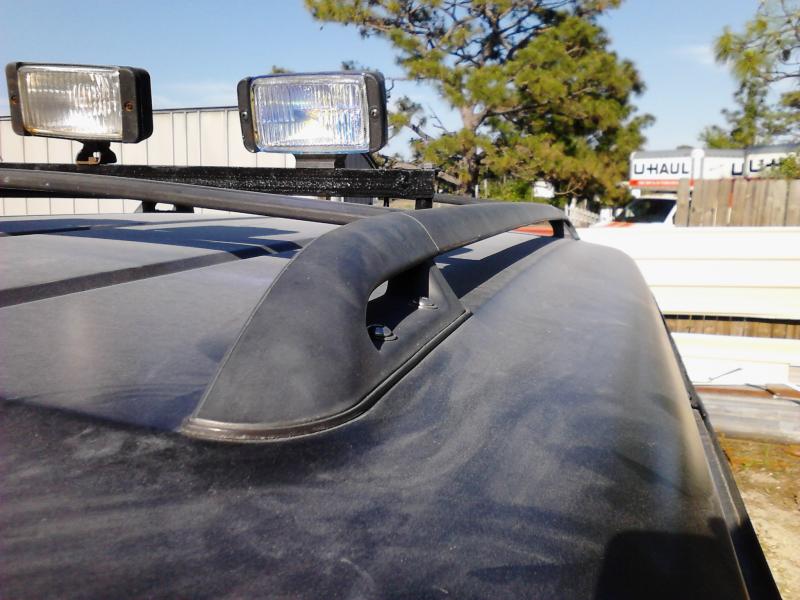

Heres some pics of the roof rack, but on the spare holder ive just got it bolted through the sheetmetal right now with big washers on the back because the body is so beat up and rusted it doesnt even matter lol, ill get new quarters later. But I got the spare holder for 20 bucks at pick n pull but im not sure if its stock or not, and the roof rack was stock on my friends blazer(four door) and he gave it to me. And im located in panama city beach, florida.
