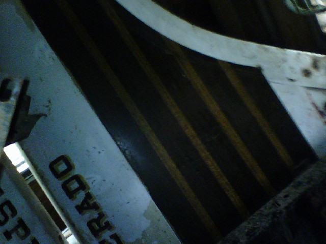

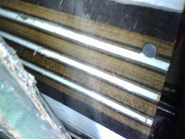

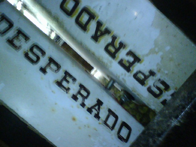

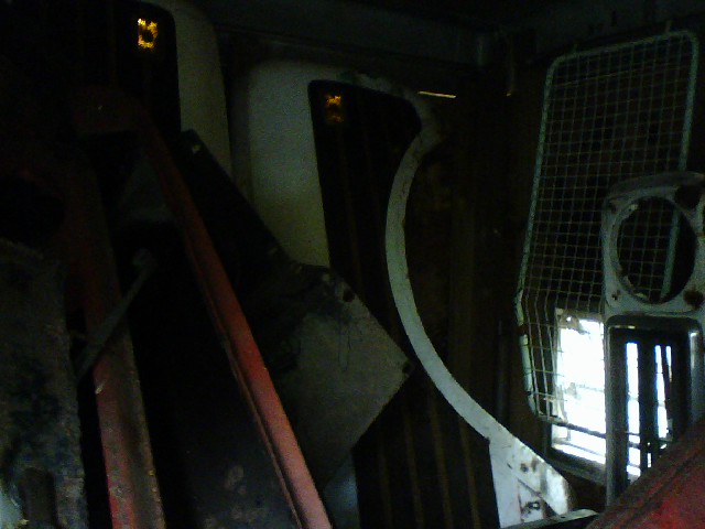

The desparado Scout is a traveler midas style interior, a kinda of wood plaid cloth, those spun metal decals on the dash. Clock overhead, map lights, twin sunroofs, white paint, decals (see the picture) consoles between front and back captains chairs. Front ones rotate. 345 auto unknown gearing. Late seventies yearage. 4x4

Ok lol makes sense.... Hey did the pictures for the desperado decals come through? Ever see them before?
