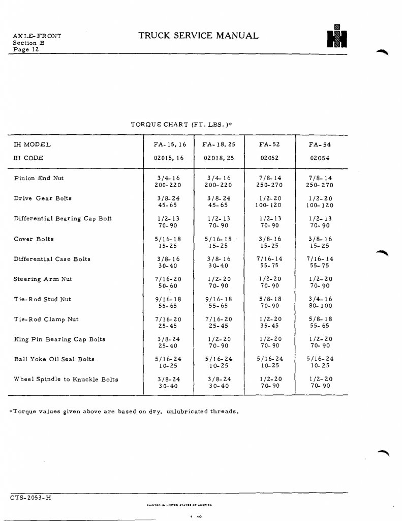

im having to replace both front original axel shafts. pretty cool they held up for 43 years !
its been forever sense i have had the axel apart, (1997) for the 8 nuts/bolts holding on the spindle is there a torque value ? i cant remember if i torqued them or just got them tight.
replacement axel shafts and U joints are on order from IHPA
