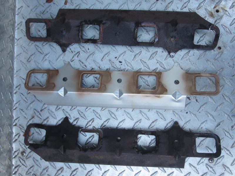

An update on my EM bolt extraction...well, it was anticlimactic, the bolt came right out with no issues. I was able to get it out, clean the threads, install my starter heat shield I bought from IHPA, put back together with anti-seize and thats as simple as that...
Thanks for all the help.
