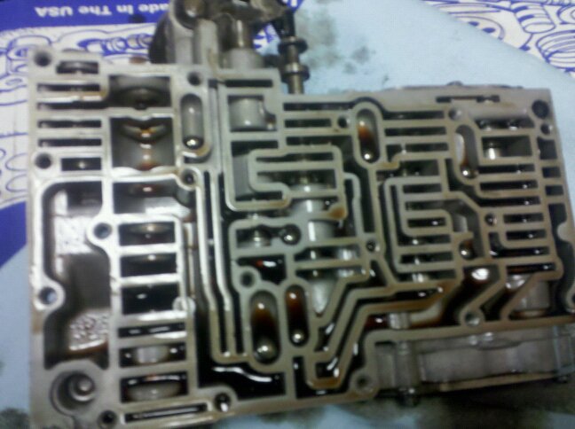

Here's an establishing shot of the valve body in full disassembly. Do not be intimidated...it looks daunting but you can do it if ya have a nice place to work and are not rushed to get it done. Take your time and triple-check everything. Anytime you walk away from the table/bench, be sure to cover everything (I use old sheets) so bugs, pet hair, kid's fingers, etc. Are kept out of the parts pile.

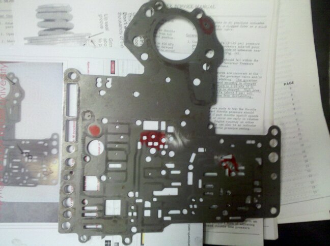

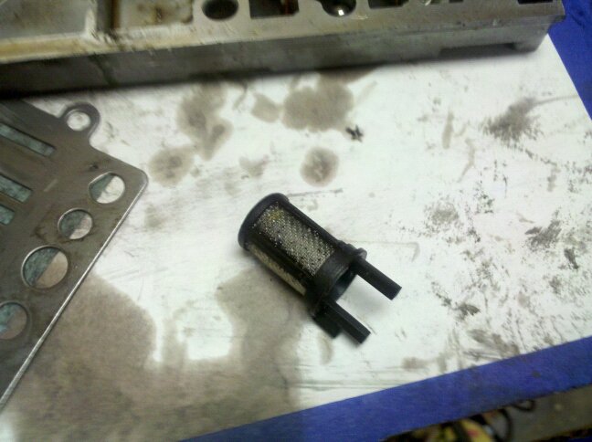

All your info and pictures have been a huge help. I dove into it already, got it apart and got about halfway through. Can I clean the tiny filter that's inside the valve body? It has some metal stuck to it, I think I can blow it out and clean it with solvent. I drilled the plate that's sandwiched in there, it was different than the one you posted pictures up of in the reprogramming install thread, and a little different than on the sheet. I attached a pic of it I drilled the same holes you did with the 3/16 bit in the kit, some were bigger than the bit. The truck it came out of was a 1979, but after 20+ years who knows what it could be...:confused5: I drilled the "bridge" out of the upper valvebody with the adapter, drillbit, and stop included in the kit. There was nothing in my bypass chamber so I left it alone. I ground down the throttle pressure valve stem also and reinstalled that. I used a flat file to grind a groove in the body for the manual valve. I stopped at the "shift command" section, I'm on the fence about it. It seems it can come in handy, I'll only be doing light wheeling with this truck and hot rodding around town. Should I go through with it, or can I mess it up if I'm not careful?
Thanks again for the help! :yesnod:
-jon

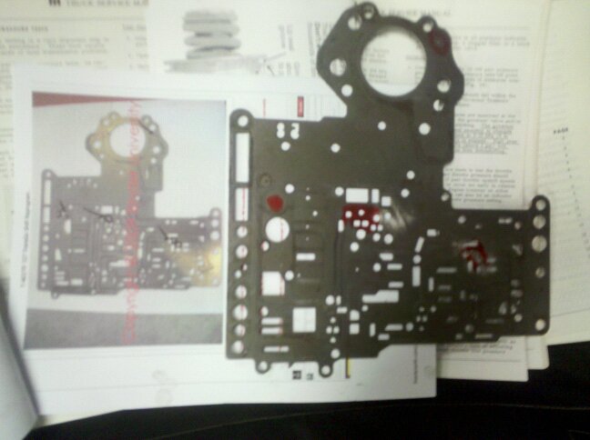

p.s. I added a pic of my valvebody just for a reference to where my balls are....:rolleyes5: ckeckballs! Haha

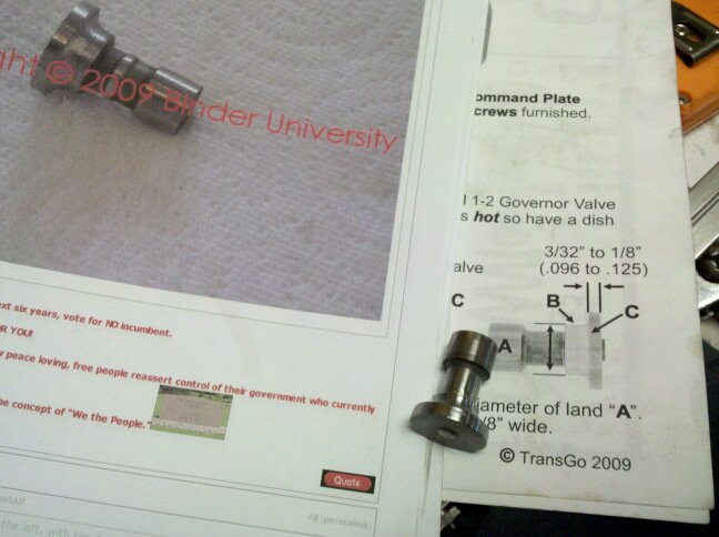

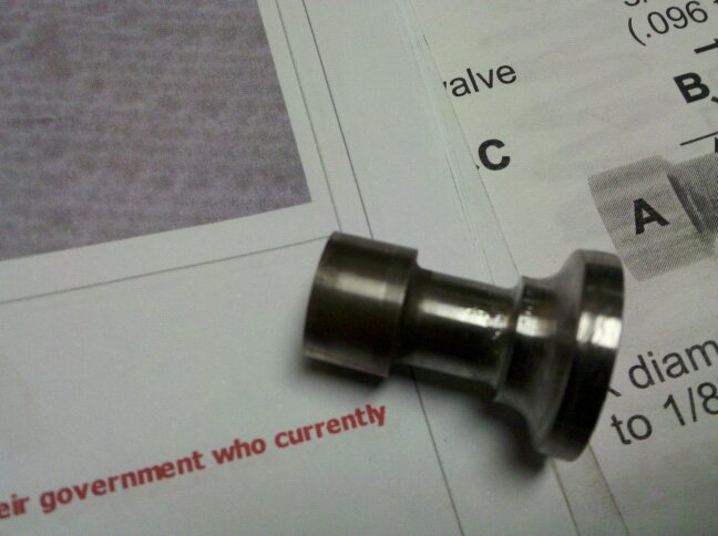

Also ground down the piece for the shift command, looks like yours and the photo they listed! I chucked it in the drill and let it spin while a little finesse with the carbide bit on the air grinder then some polishing with some fine grit sadpaper till it was all shiny and smooth! Also Mike, I noticed in the pic in your tf-2 install thread you installed the plate "sideways" compared to what the instructions showed, is there any reason for that?? I installed mine as the instructions listed.

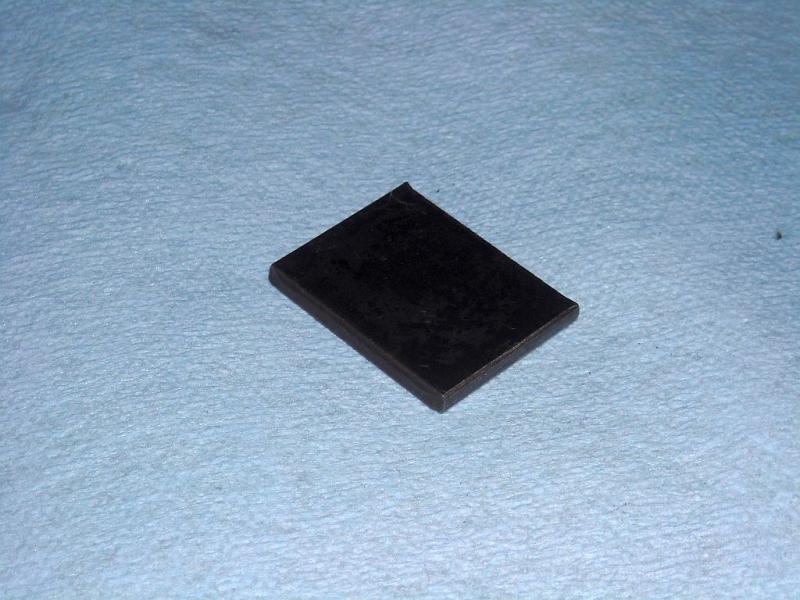

Regarding the position of the shift command blocker plate shown in my pic, the actual position doesn't matter as long as the hole is in the proper location. But you are correct, my positioning doesn't match the instructions.
Grind job on the governor valve looks just fine.
That small nylon filter is for the pressure regulator system. A new replacement filter comes in any master overhaul kit as part of the package. But it certainly can be carefully cleaned and re-used. Having that filter in your valve body tells me that transmission is late '77 and later production unit and also is a "part throttle kickdown" unit. I can see the module attached to the valve body in your long shot.

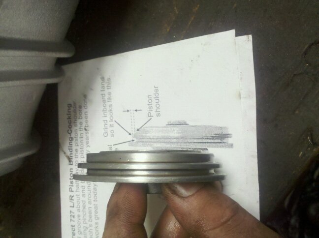

As for removing the low/reverse servo piston...it's tricky. When installing a shift reprogramming kit in a fresh transmission build on the bench, it's much easier to do the case-related mods as it goes together of course!
Back out the band adjusting screw nearly all the way. Then use a long piece of wire to pull it fully to the position where the band is "tight" on the drum, do this carefully so that the band apply strut doesn't jump out of position which is a bitch to re-install! Tie the tag end of the wire off on the opposite side of the trans to some anchor point to hold it in position.
Then use an appropriate "c" clamp to compresses the piston spring cover and remove the retaining ring. The "c" clamp is also used to compress the piston assembly when it goes back in after the modification.
Once the piston has been modded and the land diameter reduced by grinding down the lower lip, the piston is now pretty much immune to the "servo flop" issue that can be somewhat common on these units when the bands are not adjusted or it's shifted into reverse with high engine rpm. Do that and there is no need for the common aftermarket servo piston replacement using a steel or aluminum piston with teflon rings unless there is evidence that the piston has previously flopped which means it should be replaced with the aftermarket piston that offers additional support.

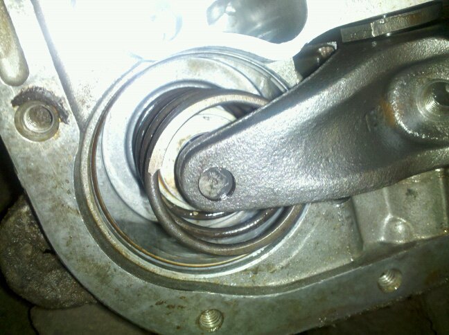

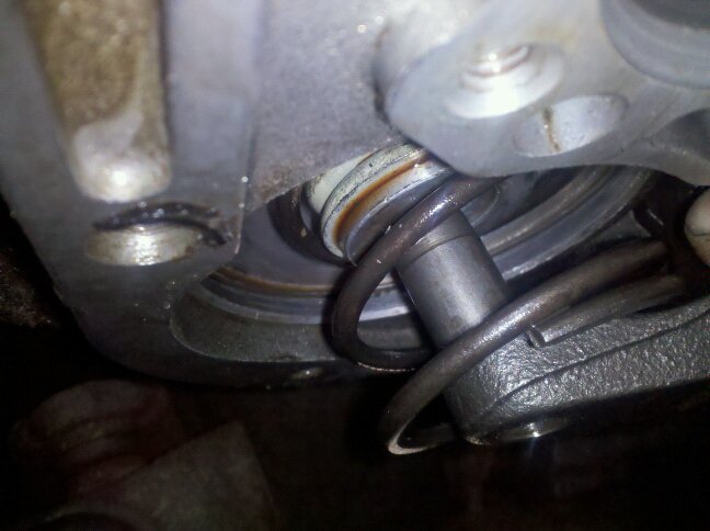

I pulled the arm back as far as it'd go, got a c clamp in there to take the tension off, got the c clip out, and the round spring retainer out. I cannot see how I'm gonna get the spring and servo piston past that arm. Ill post pics when I get home later....:icon_confused:
-jon
The picture with my fingers is as far as I can pull it down, then from the bottom I can't see any way the spring would fit around it.... :icon_confused:
-jon

the picture with my fingers is as far as I can pull it down, then from the bottom I can't see any way the spring would fit around it.... :icon_confused:
-jon
I have not experienced this issue in the past. Granted, it's a tight fit and much easier when the trans is on the bench. I r&r the servo with all the linkage out of the case (the pivot pin removes after removing the tailhousing) but this is not the thing to do in your situation) before installing the rar band and apply links.
Have you backed the band adjust screw all the way out so that it does not touch the intermediate lever?
If ya still can't get the space needed, then you need to carefully remove the apply link using forceps. It's real tricky but can be done, and the re-install of the link is even more tricky!
Once the apply link is removed, then the arm will drop completely out of the way.

The exact amount of the piston lip to be removed through grinding is not real critical, idea is to simply open the space under the lip seal to allow a more even distribution of oil pressure to help stabilize the seal, therefore stabilizing the piston. If you do not grind down the piston however, you will never know the difference since this transmission ash not failed previously through a "servo-flop".
Well let the reassembly begin!! :icon_up: I ground it down till there was some clearance between the lip of the seal. When I put the supplied collar on I couldn't get the c clip to seat, I had to grind 1/16th off it so it'd seat the clip, I hope that doesn't matter!! :yikes: then there's not much resistance to get that piston back in there is there? I make myself nervous with stuff like that it seemed too easy to put in. I put the supplied spring in and put the spring retainer and c clip in, that was interesting, I couldn't make the c clamp I had work so I squeezed it with my hand, and put the clip in with the other, it took about 25 minutes and some choice words! Then it only took 2 attempts to get the strut in, it was alot easier than taking it out. I adjusted that band and the other band as per the instructions (but I torqued it to 72 ft lbs.), then I put the valvebody in and torqued the bolts to 100 ft lbs, and got the e clip on the park pawl linkage. I need to get a neutral switch though because the seal looks brittle and is flaking off. :icon_confused: I'm going to have to cut my exhaust to clear my deep pan before I do anything else.
