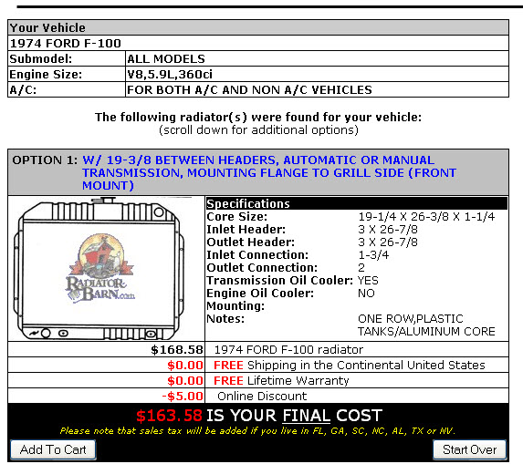

Sparky! I'm guessing no based primarily on the fact that I've never heard that combination mentioned as a workable solution before. The only way to know for sure is to take measurements. Then there's the upper/lower hose locations. Are they in the right places? How about the mounting brackets? Good luck sparky.
In 1974 Ford was not using a cross flow radiator. But IH was in the Scout's.
As you can see from the pic the size is a bit wide and you will need to make an adapter to to get one hose to fit. Scout's have 2" hoses. Plus the outlet will be right inline with the power steering belt. As it's a few inches shorter then a Scout rad.
You can look for a good used rad , or recore for about $300 or

I made a big u-turn in my Ford/mopar summit rad to miss the power steering belt.

Fwiw Scout have a huge radiator over anything else you will find in the junk yard. Its over 500 sq inches in size.
