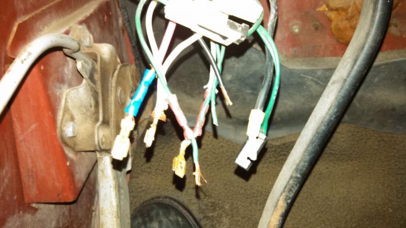

Working on a 1967 IH 1100 3/4 ton truck and have to replace the entire ignition cylinder because the truck didn't have one when I got it. Thinking I'll have to probably order the factory one from here, but bought a standard 3 pole ignition cylinder switch from napa...
But, nothing is connected and all the wires are stripped out, so I need to know which wire goes where lol
a wiring diagram would be fantastic, but can't seem to locate one at all, so...I've attached a pic of the wiring mess. It'll crank over when ya touch the power wire to one of the white wires...but we have no spark...id love help with this one!

Napa carries the stock switch (same as postal jeeps) I'd look for the vee shaped plug to make it easier though.
The wires were all labeled when new, but the id May not be legible at this point. Assuming that it is legible, here are the ig switch circuits:
#11 - 10ga wire originating from the + terminal of the ammeter gauge and terminating at the ig switch 'b' terminal.
#12 - 20ga wire originates from the ig switch 'I' terminal and runs to a 4-way connector where it intersects with two wires also labeled #12. One of which runs to the starter solenoid 'r' terminal. The other runs to the coil + terminal.
#14 - 14ga wire originates from the ig switch 's' terminal out to the stater solenoid 'b' terminal.
#102 - 16ga wire originates from the ig switch 'a' terminal to the fuse block which then feeds the heater switch.
#71 - 16ga wire originates from the ig switch 'a' terminal to the wiper motor switch 'b' terminal.
#129 - 14ga wire running from the ig switch 'I' terminal to the voltage regulator #2 terminal.
Good luck.
