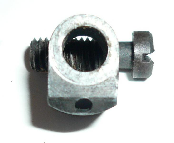

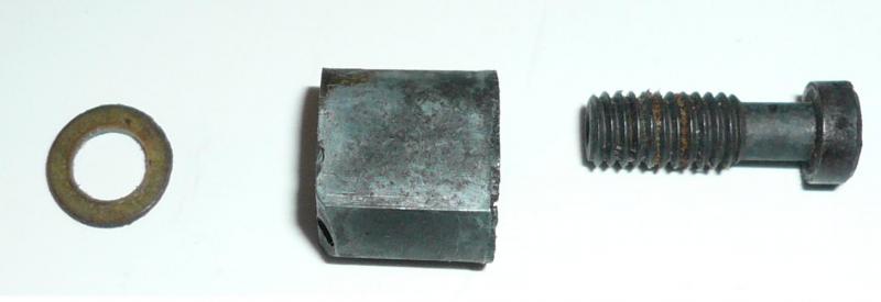

I have a Scout 80 with a Holley on it im not sure what model but the 4 numbers on the top are 2494 and the discharge nozzle gushes fuel all over the place what is wrong? I thought it was only suppose to spray a mist
Ok that is fairly normal for the 1904. They don't have a sharp stream but rather a coarse shower discharge. Not very precise but gets the job done. You can remove the nozzle by removing the screw in the top of it and make sure it is ok. Don't drop it down the carb. I attached some photos of one I have around.. Th crecent shaped opening seen from the top view is kinda a cup with exit in the bottom. The fuel is pumped into the opening in its bottom and should spray out generaly. If the hole in the bottom becomes obstructed it will fill up and run over the top and all around. Take the shooter nozzle off and make sure the gasket is intact and the openings are clear.
Shooter components
Nozzle bottom view
Nozzle top view
