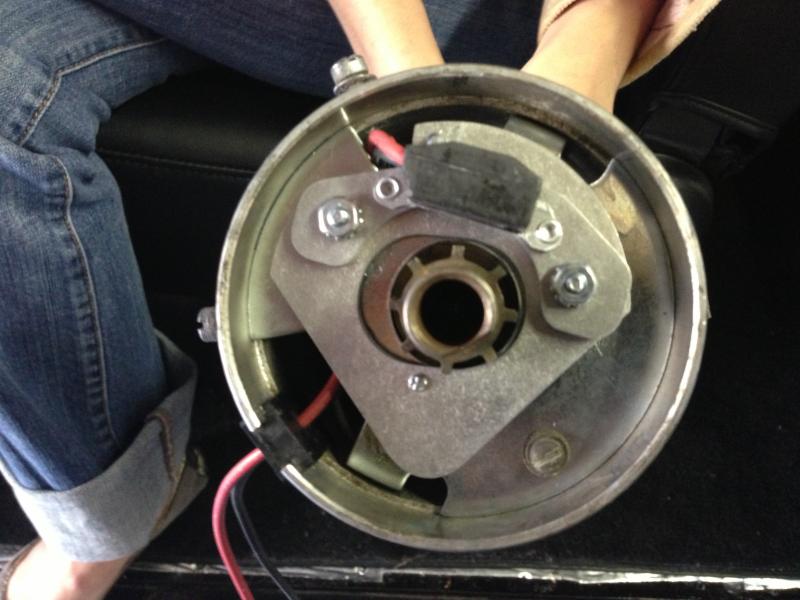

Couple questions before I seal it all back up.
Air gap is at .213 spec is .200. Good enough?
Does this distributor require the ground wire that came with the pertronix I? I don't think it does but would like to make sure.
I have the distributor apart and am wondering what the advice is on wire placement of the pertronix. I currently have the wires running underneath the plate and out. Somewhat like the stock setup. There seems to be less underneath for the wires to catch on than running them above the plate. Is this how others have routed the wires?
thanks,
Mark
That is how I ran my wiring almost a year ago and haven't had any problems. It's a good company. I just called them and said, "hey, your box arrived. Anything I should know?" and the techsupport walked me through it. Just give them a call if you have questions. Good luck.
I have always used the grounding wire that came in the pertronix kit. Two of my own scouts have prestolite dizzies and had not run the wires like you have. But it looks like it works.
Thanks for the responses. Looks like I'll just keep it the way it is. According to pertronix the air gap is just fine. I am going to use the ground wire as well. Waiting on vac advance canister from IH only that will be here today and this dizzy is perfect again.

Were you able to keep the pertronix wiring under the plate, like in your photo, when you installed the new vaccum advance canister?
Btw - I forgot to mention in my last reply that I have not had any issues with the air gap once it was all installed. Was all plug and play and forget about it.
were you able to keep the pertronix wiring under the plate, like in your photo, when you installed the new vaccum advance canister?
I probably could have run the wires underneath but decided against it once the vac advance went back on.
