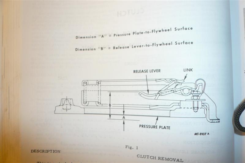

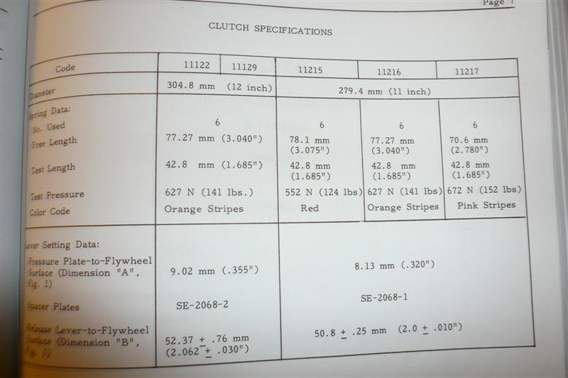

The manual states on the 11" angle link clutch the clearance should be .320". I had a local clutch rebuilder rebuild my pressure plate and the clearance is only .210". Did they screw up or am I missing something? This was to be motor install day and this is the last item before install.

The measurements that the manual states is unclear if that is with the flywheel/pressure plate assembly engaged or not engaged.

That "dimension a" is with the freshly remanned clutch cover bolted to the flywheel with no clutch disc in place and in the "released" mode...just like driving down the road. That way when the disc is mounted, the release specification will be correct for the "throwout" travel, and provide plenty "lift off" of the pressure plate when released and not create any drag.
Your clutch builder May need to machine down the replacement pressure plate to achieve the spec. And take the flywheel also so they will have a reference if they don't have a test jig (they should have a test plate to verify any rebuilt clutch cover assembly).

So as I follow it if the flywheel, clutch disc, and pressurre plate are bolted together the part "b" measurement (flywheel to release fingers) should be within spec. The manual states 2.0"

I can understand the measurement of the pressure plate to flywheel with the disc loaded, meaning as if the clutch is engaged. The more critical measurement I believe is the flywheel to release fingers. When the assembly is installed if the clearance is not correct the linkage adjustments are not infinite, you can only adjust in /out so much.

I believe that dimension "a" is for disassembly and setup, not a clearance per se. If you are using the same manual I've got, cts-2518, in the assembly section it states to use spacers of a given thickness or a spec'd tool number under the pressure plate before it's bolted to a surface plate. From there once it's bolted down, the release fingers are adjusted to the specified height. I see this as getting the finger height while the clamping pressure is on.
In the clutch specifications chart under "lever setting data" it lists the dimension "a" and the required spacer or tool number.
In another service manual, cts-2039-a, and the section I'm quoting covers a different style of clutch but the same procedure, it reads: "select spacers of proper thickness from se-2068 spacer plate set and place the three spacers at equal distance under the pressure plate, fig 7. See specifications for the the spacer plate requirement." again dim. "a"
so once the clutch is bolted to a jig or flywheel with the right spacer, then The release finger height can be attained. The adjustment has a finite range, so right along with what Mike said about the rebuild shop; the pressure plate has to "fit" the application.

The proper way to set up a coil spring adjustable pressure plate is to mount the pressure plate assembly to a flat surface or a flat flywheel with the specified spacer with a thickness = to dim a between the flywheel and the pressure plate. Then set each lever via the adjustment screw and locknut so the distance from the lever tip where the through out bearing presses and the flywheel surface is = to dim "b". I get them as close as possible to the same measurment. A high or low lever can cause the clutch to shudder.
Have done many of this type and they all work great.
No way to set up one of these in a free state. They must be mounted, loaded and, set.
