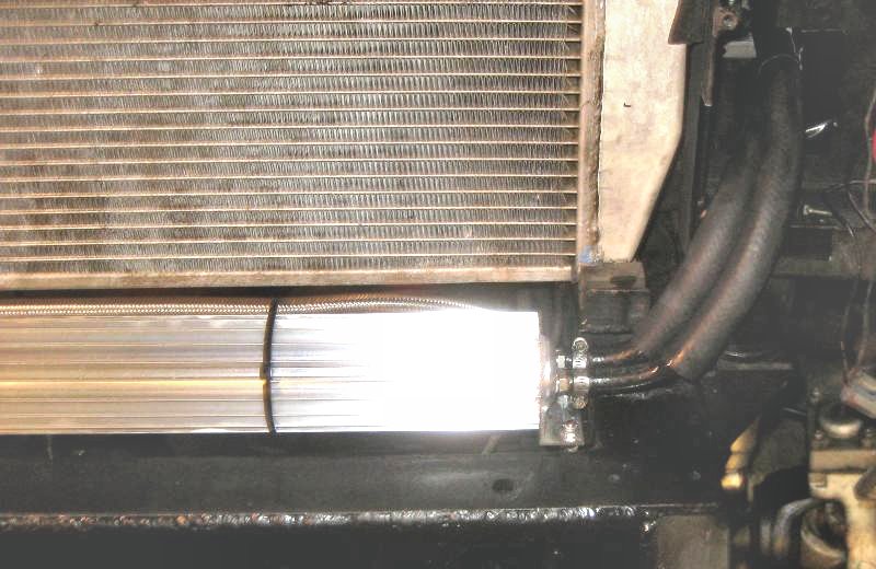

I installed my power steering cooler, which added an extra qt of fluid to the system. Since my ps also run a hydralic ram and the hydroboost brakes in addition to the ps box, it needs a nice free flowing cooler. So I order a derale 13266
attachment.php
attachment.php
Nice work --
off topic - personally, I would find some rubber grommets to put around the cooler hoses where they go thru the front sheet metal.
Its a bit dark, but I used some 3/4 heater hose over the top of the power steering hoses:ihih:
