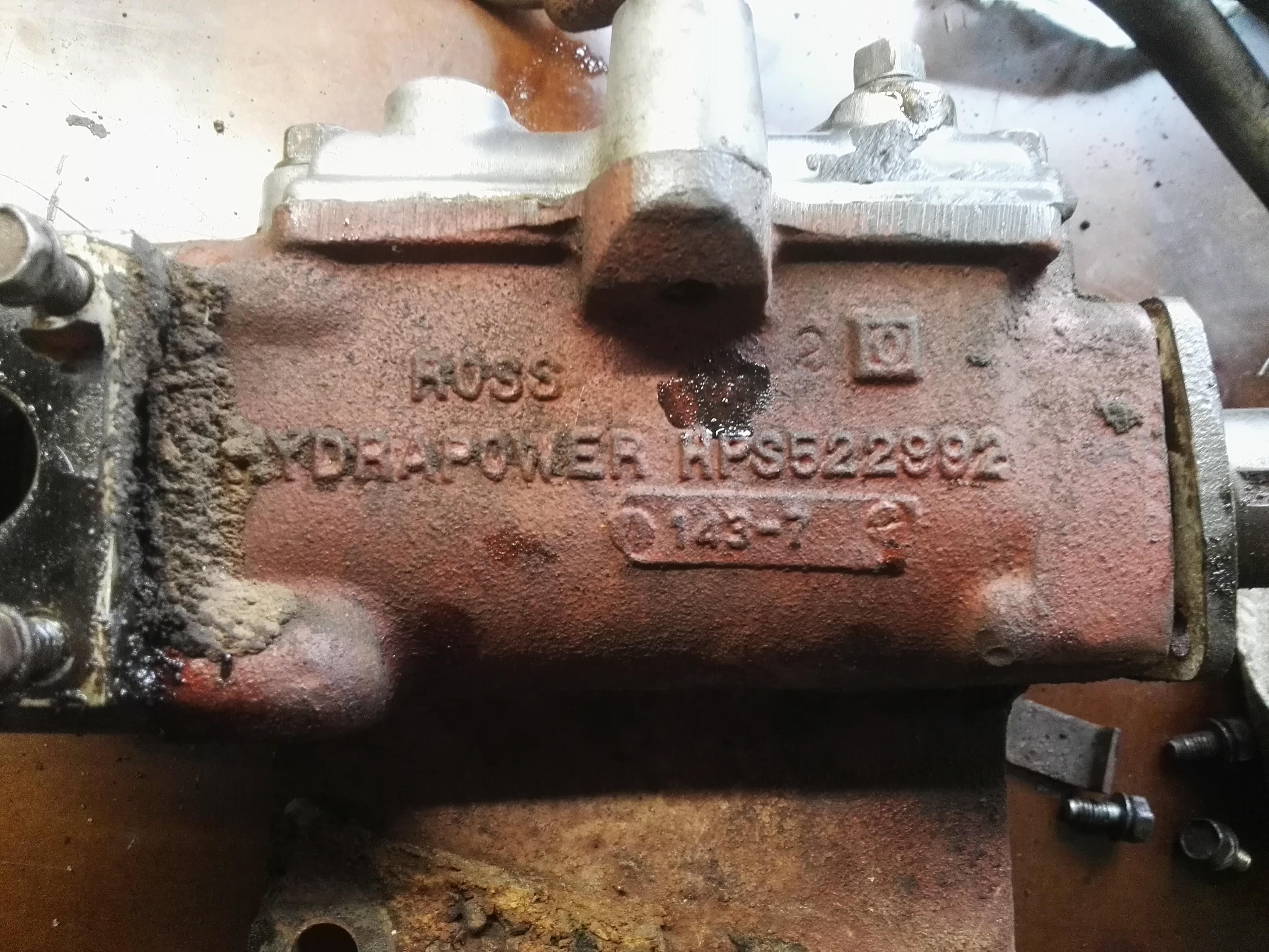

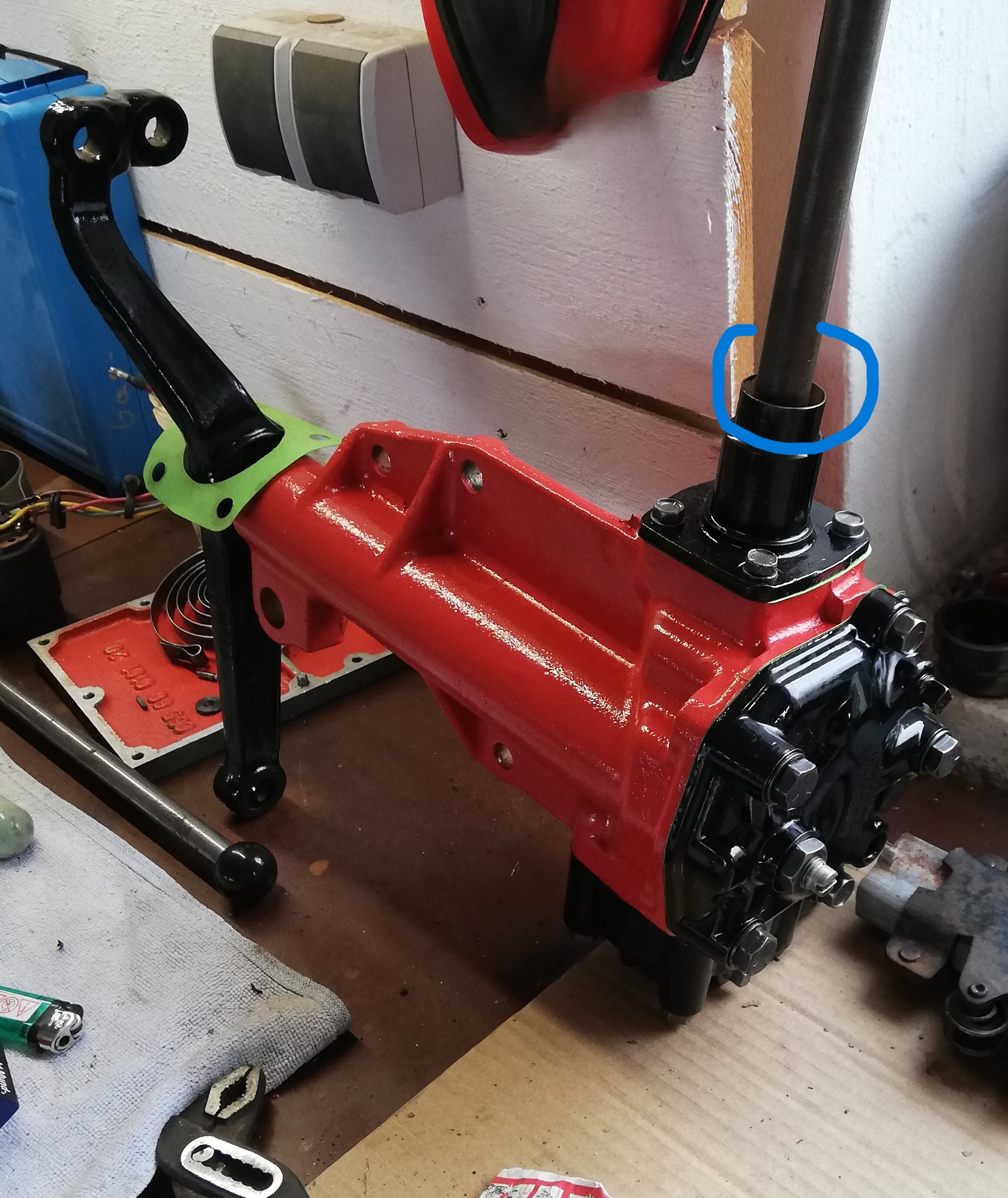

Ich habe eine Frage zum Servolenkungsgetriebe meines Travelall von 1967.
1. Welche Art von Dichtung gehört in den blau markierten Bereich im Bild?
2. Welche Art von Fett oder Öl sollte ich im Lenkgetriebe verwenden?
Ich habe hierzu bisher keine Informationen gefunden.
Vielen Dank für Ihre Hilfe.
Viele Grüße aus Deutschland

I have a question about the power steering box on my 1967 Travelall.
1. What type of seal belongs in the blue area in the picture?
2. What type of grease or oil should I use in the steering box?
I haven't found any information on this yet.
Thank you for your help.
Best regards from Germany

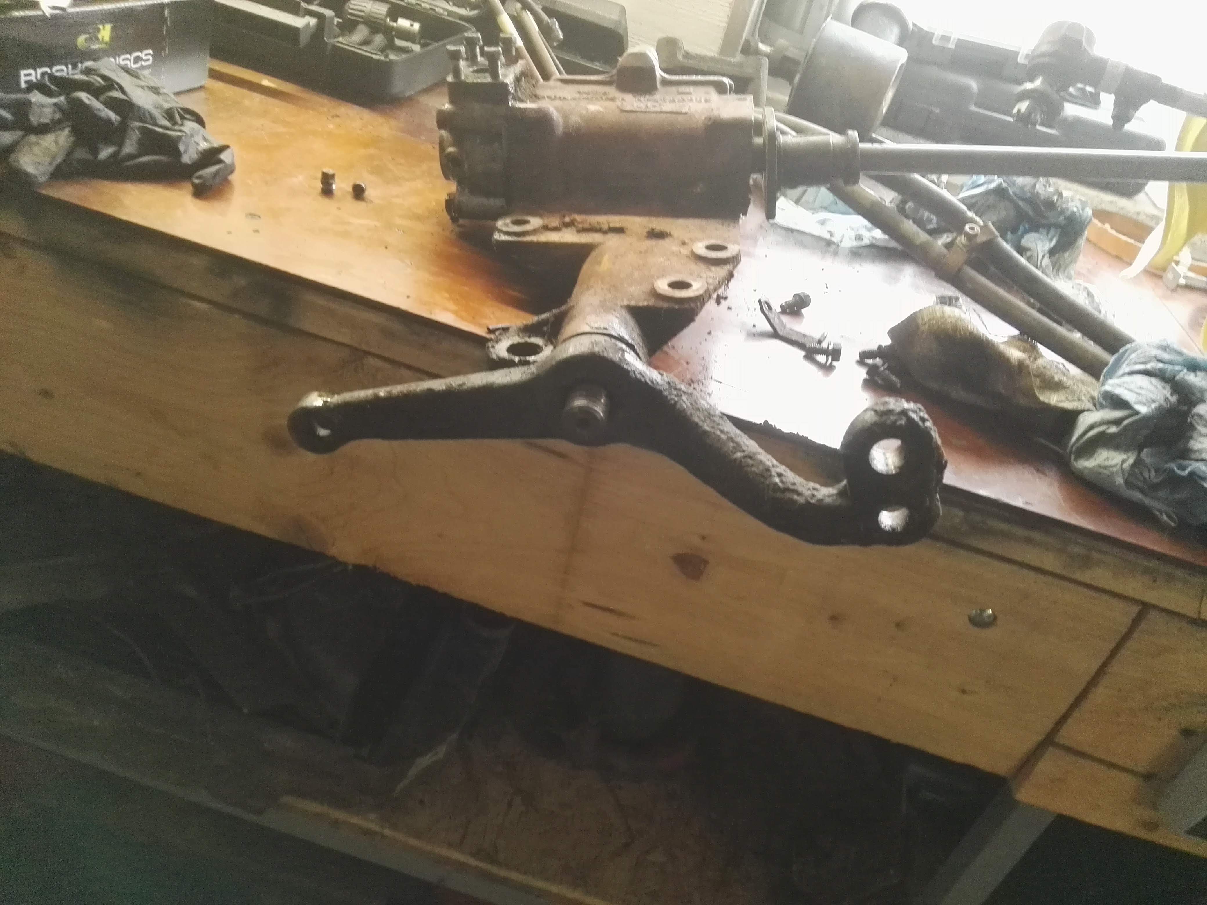

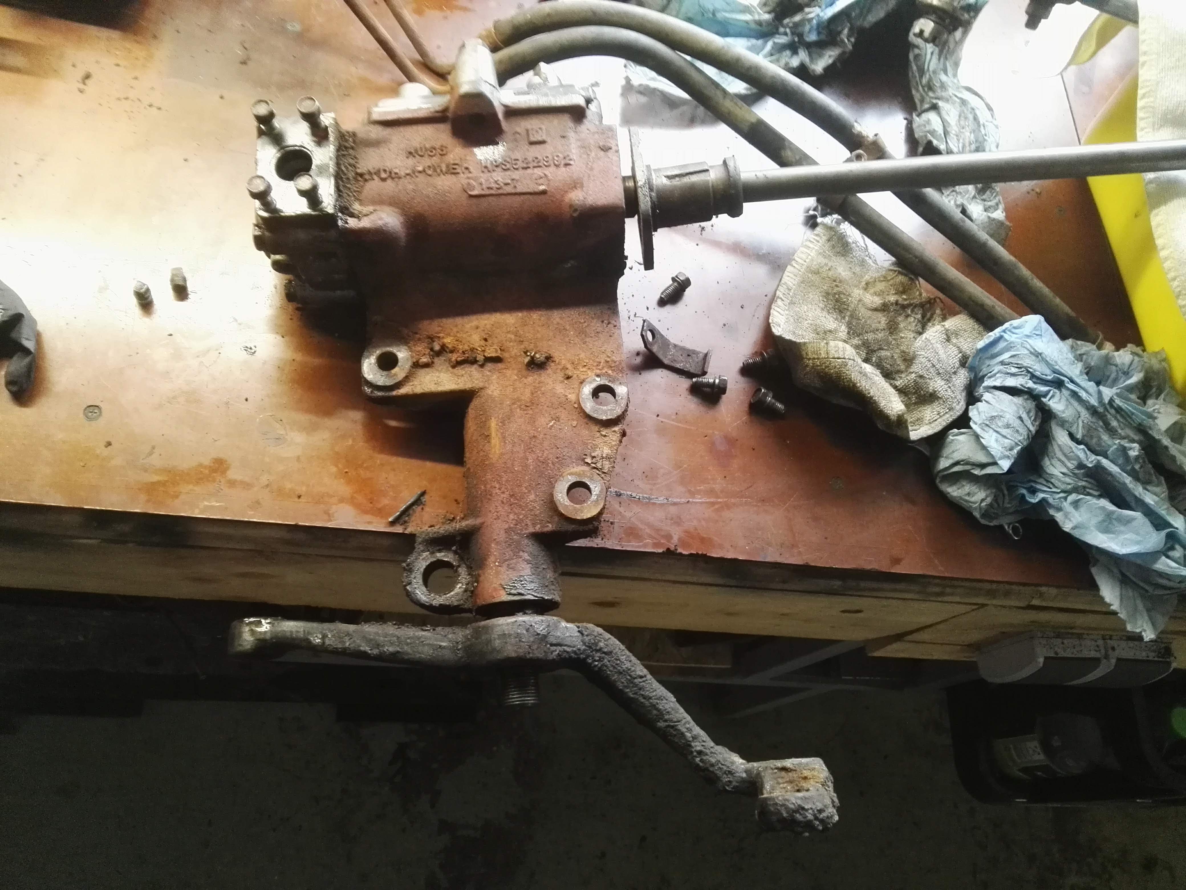

Here are some more pictures of the steering gear
Thank you for the additional info. There must have been some kind of snafu with the first post, because it is most certainly in German, so I don't know what was up with that. Anyway, your subsequent posts have all been in English, so we seem to be good now. I'll consult my parts catalog and see if I can come up with some info for you.
The parts catalog does not list each seal separately. Apparently there is a rebuild kit that contains all the needed seals for this gearbox. The IH part number for the kit is 160330H4. A common aftermarket supplier of this kit is Edelmann 7857. I'm not well versed in the gear box servicing. That's the best I can do for you from an information standpoint.
