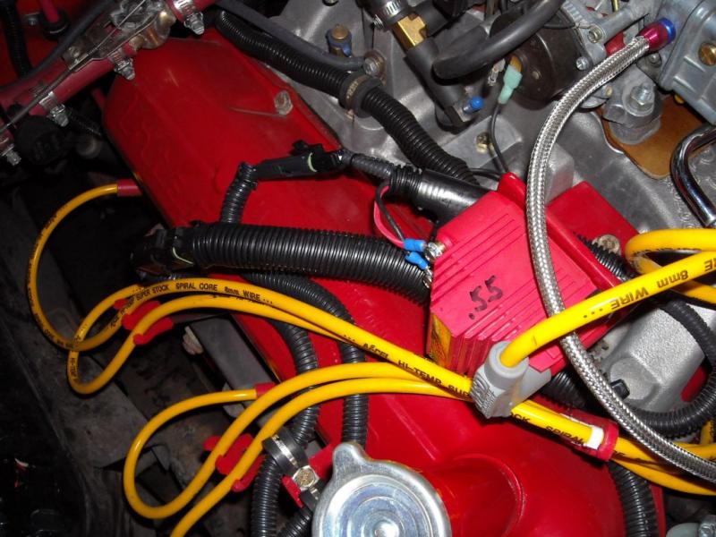

Mr. Mayben, would you happen to have a diagram or link to the wire routing that you prefer? Right now mine is all over the place, but would like to make it look right and not cause any issues.

The plug cable routing on my rigs are both different and nothing at all like a stocker! I have to keep my stuff very flexible in this regard since I'm constantly removing and installing distributors for testing purposes. And I have some fairly strange distributor cap configurations that I swap in and out depending upon what distributor/cap combo I'm testing that make for one more reason I prefer to terminate my own cables.
This pic is one way I routed when I did the rpt manifold install, these are the accel wires with wire markers attached. This shot shows an oem-type coil but relocated on the bracket to stand it up.
I pay $48 locally on the shelf at o'reillyshucks for the msd universal cables, the accel cables are around $56 at knecht's.

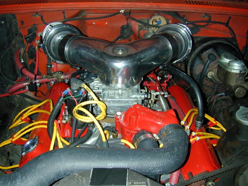

This is a more recent pic, this rig is now running a mallory six cd box with an appropriate low resistance msd e-core coil triggered by a pertronix inna Holley points distributor. More info about these performance ignition systems are found in this thread:
http://www.forums.IHPartsAmerica.com/ignition-tech/644-ignition-system-performance-upgrades.html
The Travelall is currently running around with a partially-completed msd cd system. The plug cables shown in those pics are the msd items. Since that rig has ac, the cable routings are a bit different and I've since added a bit of cable looming. The distributor cap on that one currently is a Ford duraspark system that has been somewhat modded to fit, therefore I'm running female cap terminations on it. That cap is being tested along with a mag trigger setup that we May offer through ihon in the future, I don't want to show a pic of that setup as it May or May not end up being feasible.
