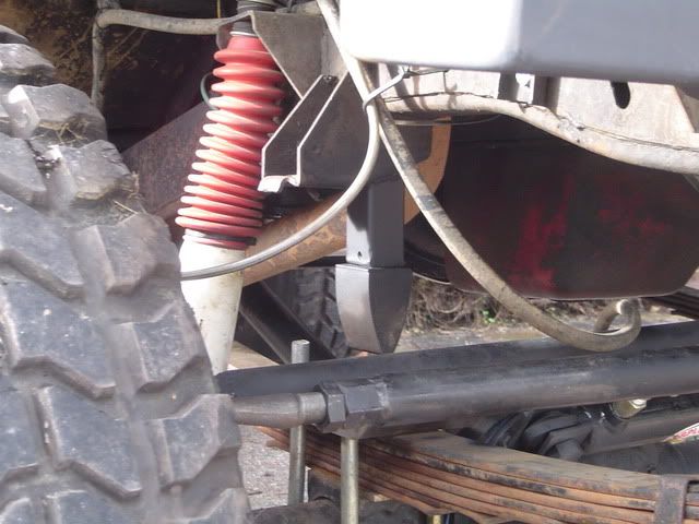

Pictures of bumpstops and mud flaps. The mud flaps are easily removable which is a good thing because they look ugly!
There is only a couple of inches of uptravel due to tierod/oilpan issues.

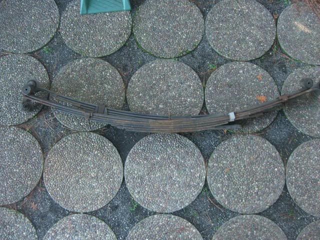

So once I removed the spring perches, I decided to go ahead and swap the rear springs. I had originally thought to pick up some Chevy 56" springs and use the off-set center pin to stretch the wheel base about 4". However, I found some 63" springs on a 90's suburban that I liked. I placed them side by side with my Scout II rears (that had a few extra leaves) and the 63" springs are only about 4" longer. So, with re-working the front mount for the rear springs and fabbing up a new rear shackle mount, I should have the 4" stretch I was looking for without too much drama.
Here is a photo of the two springs on top of each other.
And I pulled some 52" springs that I eventually plan on throwing under the front of the Scout. They are the ones on top, with the Scout II rears in the middle, and the 63" on the bottom.

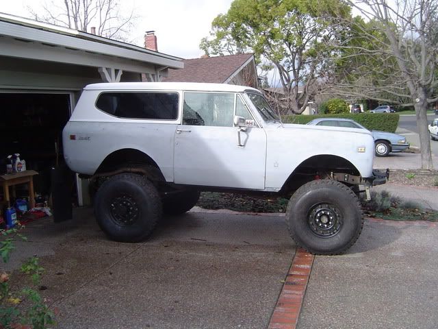

I also finally mounted a winch, and welded the bumper on. The cb that my wife gave me last Christmas is still waiting to be installed though.
