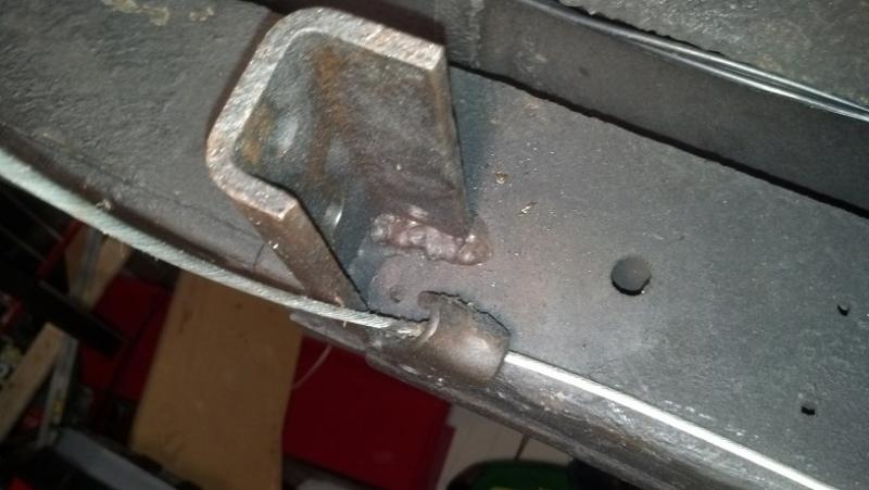

I have a 1980 turbo diesel traveler. The parking brake cable has always been difficult to set and I figured it was not installed correctly. Recently the front cable failed and I set about replacing/repairing the whole setup.
To make a long story short, it looks like the po replaced the parking brake cable but ordered the wrong one (around 12 feet long instead of around 15 feet long). I assume that's the cable for a Scout II, not a terra/traveler. It looks like he chose not to replace the cable with the right one, but instead welded a bracket directly in front of the passenger side front cable guide and moved the front cable over there. (sorry - no "pre" pictures. I pulled the cable before I thought about pics.)
this had two effects: first, since it's now a straight shot to the driver side rear wheel, the pedal travel was significantly reduced. Second, the front cable was in contact with the transfer case, and eventually frayed.
I'm half way through putting the brakes back together right, but want a sanity check before I go do something hard to undo.
Take a look at the following picture of the front parking brake cable guide on the passenger side. Does this bracket belong here? It interferes with routing the parking brake cable to the center of the transmission cross member. It looks like the po welded it in, and I plan on removing it unless someone tells me I'm way off base here.

The turkey-turd welds say booty fab to me. Do you have the rod with a hook on one end and curly-q bend on the other? It is used for taking up some of the slack in the cable on the passenger side.

Holy booger welded bird poop batman. I be guessin that the po got tired of his stale bubble gum.
Those half hoops that the cable in photo is hooked to, two of them welded to the frame, looks to be partially right. As mentioned earlier, there is a threaded shaft with spring and half clip coming off the e-brake handle cable that gets attached to the cable in photo.
