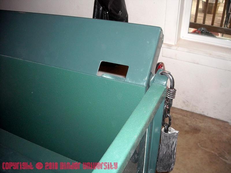

Tracy had paint formulated matching the original green color on the underside of the cab roof, and then sprayed it on the cowl vent for my approval. Spraying the sample on metal covered with the final primer coat gave me a true indication of the color match.

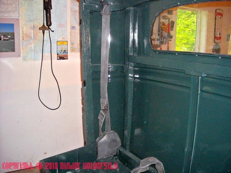

He is going to mount 3 point seat belts. A black head liner has been ordered from class tech cars. The dashboard and the metal door panels will be painted in the original black color.
