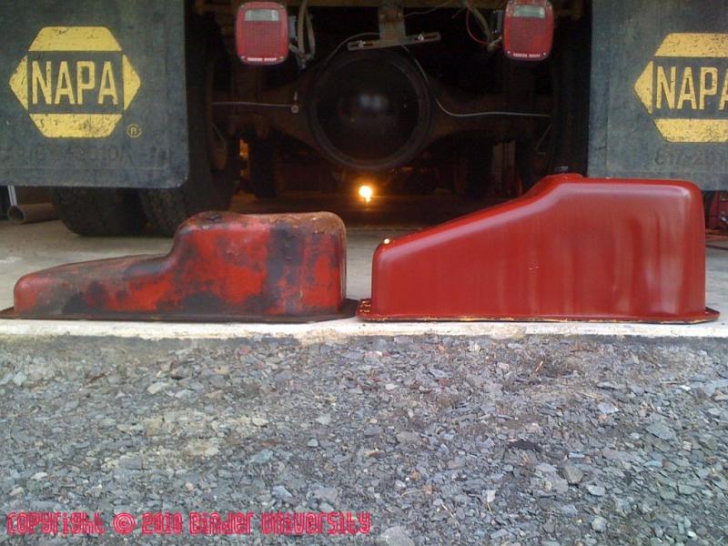

First off, a comparison of the two pans, on the left is a pan for a 345/392 as used in a Travelall (front sump). Pan on the right is for the loadstar 345.

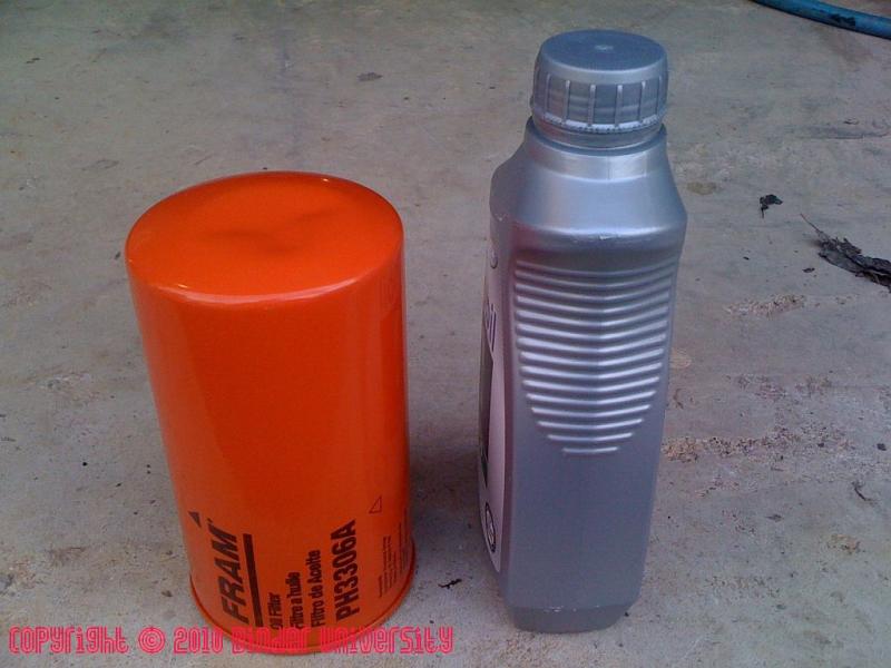

This a fram version of the two quart oil filter used with the vertical mount loadstar filter adapter.

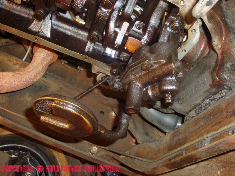

And this is the loadstar/345 oil pump and float.
I know you have no way of comparing these items, but the pickup on this oil pump has an "extension" segment on the float so that it is lowered into the pan as compared to a "shallow" pan on a pickall. In actual setup, the float screen sits about 1" above the flat bottom of the oil sump so that it is always submerged.

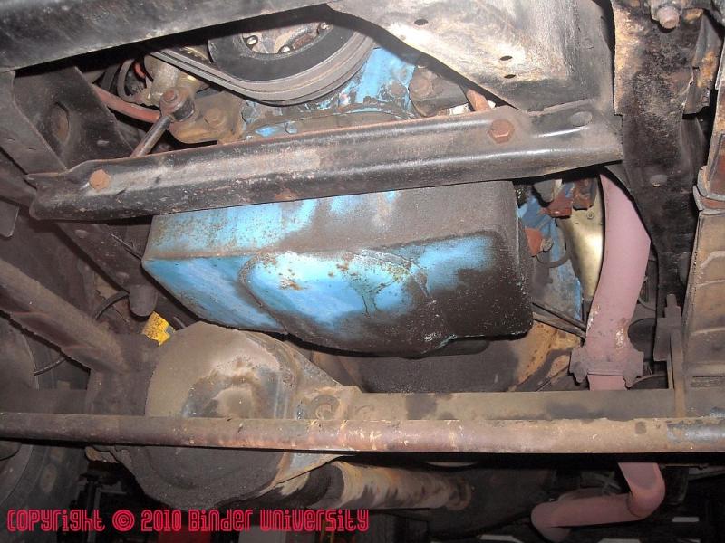

Wanna see a front sump oil pan onna sv (266/304/345/392) motor in a truck? This one was fabbed to the tune of over $500 (1988 dollars by the way) which includes a dual header, remote mount oil filter assembly mounted to the inner fender. Total oil volume is 11 quarts with both filters swapped. This is a total waste and adds nothing but bling to a fresh-built motor. Definitely a case of fixxin' what ain't broke and another way to simply soak a customer who buys into the bling thing!
And yes...the dam drain plug area leaks where the bung was welded in!!!! So to fix that, the pan will have to come off!!! The shop that did this work back in '88 is still open up in portland. I have all the work orders regarding this work. Someday I'll have some fun with this and drive up to the shop door and ask for the owner..."Mike". If he's still alive, I'll let him know I got some warranty work on this engine build he did, it's got less than 5k miles on it since the more than $6k was spent for this blingmotor!
