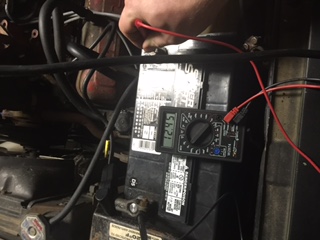

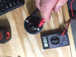

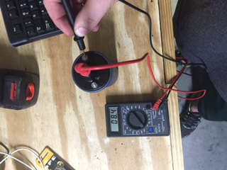

See attached pics.
I have 12.45v at battery.
Coil has 8.4k ohms high resistance and 1.9 low resistance.

Thanks for the readings. Ensuring the battery is up is a must whenever addressing any potential electrical or ignition issue as a low battery can often be a root cause. The coil primary resistance is fine and would only need additional ballast resistance from an external source if you were to revert to a points distributor.
