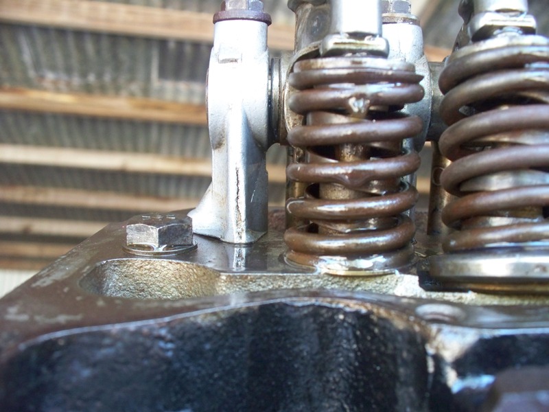

I was going through the pre oil procedure while I have the engine on the stand and I ran into a couple of issues. First the passenger side is not getting oil second I noticed what appears as a crack down the rocker stand (driver side). I now I will have to replaced any cracked stands but any tips on the passenger side oiling problem. I have printed and studied the procedure I found on this site and followed it to the letter. The oil pressure was reading a steady 15 psi during the entire time. Just some history on the engine: I had it rebuilt a few years ago and had it running good for about <2000 miles, then while riding on the highway it started knocking real bad. Took it apart and found the #2 cylinder wall scored badly along with a ruined piston I believe the cam bearings were damaged also. So now, after the machine shop did its thing, im trying to get it back in the Scout. I know the first time I ran it I did the pre oil but did not have these instuctions to follow and I also ran regular oil in it not knowing any better. Currently I am using the proper cj4 oil. Any help would be nice.

as for what appears to be a crack in the rocker stand,that location is usualy a casting Mark. The cracks that I have seen are from over tightening and usually under the bolt/washer.

And what you see on that end rocker stand is casting flash at the mold parting line for the stand. If there is an "oiler" stand installed in that position...yes, a leak would appear if that is actually a crack. If that stand is not an oiler, then no oil would appear even if cracked! That stand cannot "crack" at that position if it's a non-oiler stand, it's nearly 1/2" wall thickness at the point.

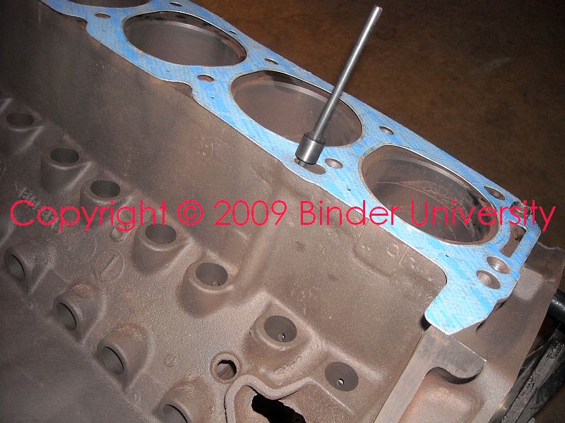

This pic shows a sample head gasket in place, with a drill bit used for cleaning purposes inserted into the feed hole for the passenger side rocker assembly. This is not the gasket that will be installed in this engine build, this is a "template" gasket I use for checking multiple points during block prep.

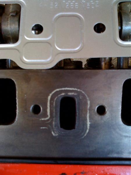

This is a shot of the block side of the head onna 345, notice again the offset in the oil passage where I've inserted the wire pointer.

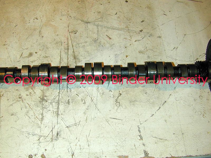

Here's a long shot of an sv cam showing two journals with the offset cross-drillings. If the hole was through the centerline of the journal, you would not be able to see both ends in this pic!

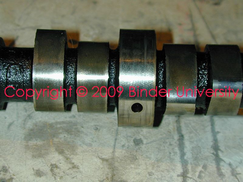

And a closeup of the #4 cam journal which is the subject of this thread.

If the head gasket was installed improperly it could block off the oil passage to the rockers.
If you look at the pic micheal posted in post #5 you'll notice that there is only 1 oil passage per gasket. You'll also notice that there is a protrusion in the gasket to match the oil passage in the block and head. With the intake and valley pan off you should be able to see if the protrusion is in the wrong place. If that protrusion is clearly visible hanging out there in the wind it is on backwards.
That gasket it for an "ic" engine the non ic gaskets have large coolant holes where the small steam holes are at along the top of the ic gasket so if your oil level is going down you May be pumping the oil into the cooling system. You can see the impression of the head gaskets coolant passage holes in the pic of the head in post #6.

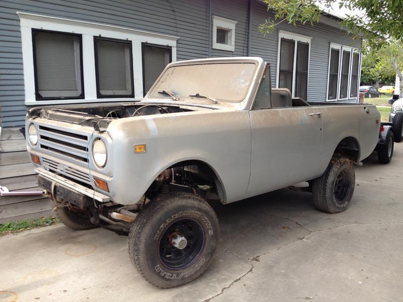

Here is a pic of my truck minus the engine which has been on a stand since my last post. So what am I waiting for?? I guess its time to get to work on it so I can finally enjoy it again.
