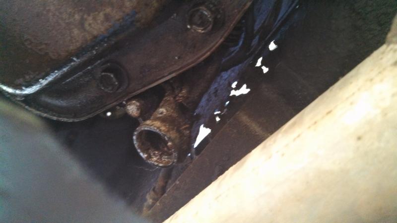

So this little gem was hanging down. What it is?
There are three connected wires to the outside. I found where it goes but that is where I now have a question.
When I plug it in, does it matter which way it gets plugged. I only ask because I am pretty sure I tried both ways and still got nothing.

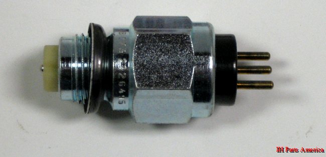

So after further review, I see that the part I didn't know what was, is a neutral safety switch. Can this be the reason it wont shift into gear?

Nope. That unit, when wired properly, is to prevent the ignition to engage the starter while the shifter is in any gear other than neutral or park.
If your shifter cable is intact, then there is internal issues. Possibly the shifter shaft on the trans itself that the cable hooks up to
That switch has no effect on forward/reverse motion. Its only purpose is to allow/deny starter motor engagement based upon positioning of the gear selector. If that pigtail was loose and you can still engage the starter...likely in any gear selector position, that means that the switch failed at some point and a po has bypassed it rather than performing a proper repair. When properly functioning and hooked up, it will only allow the starter to be engaged in park or neutral selector positions. That's not your most pressing issue. Keep looking.

Well. Seems that the neutral safety switch is functioning properly. Reverse lights function whether motor is running or not, when shifter goes into reverse. At least that's how I understand it.
