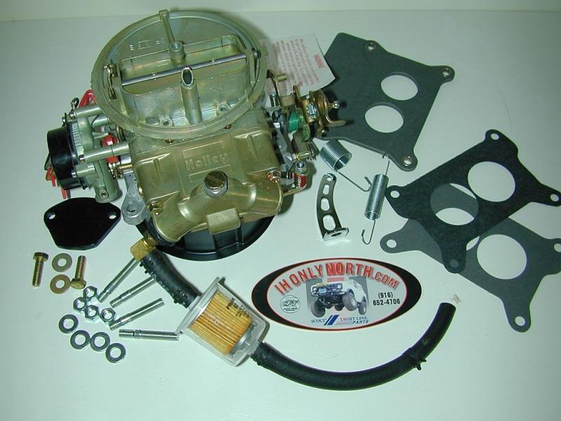

Now - on the 2300 300 cfm.
I wanted to dial in the fuel mixture (we started with 1 turn open on both sides and new 65 power valve.
When I turned open the drivers side...she bogged (too much fuel)
so I backed her back down...and 1.5 turns open seemed best. No significant change on vac reading.
Oh yeah...choke seems to be needed for a long time...before we can open her up...like 10 15 minutes...she is fuel starved still...I think...
I went to passenger side...and no matter how open or closed I turned needle...there is absolutely no change in engine.
So I am thinking we are running a 1 barrel !
I rebuilt this myself...and checked flow on passages...so this seems odd.
We want to get this right....so I am wondering if anyone can give me advice.
Also...the throttel plate vac. (small port) has no vac...so I surmize I must of blocked it off with my thick gasket somehow ( we bought a thick one because the 2210 was boiling gas...the one we took off. We didn't want the new carb boiling gas too.
The only active vac (aside from large 1/2 in vac port on back of carb throttle plate) is up by metering block..on passenger side...and it shows vac under acceleration only...so we put that to the distributor..right?
