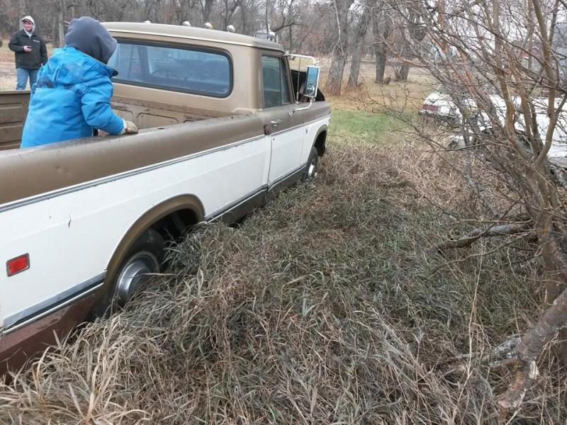

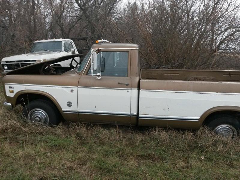

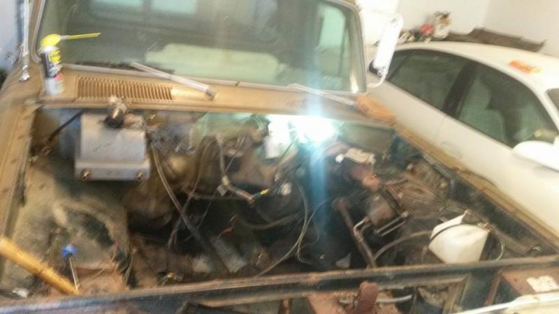

Here are a few pic of the truck it was sitting like this for around 9 years
